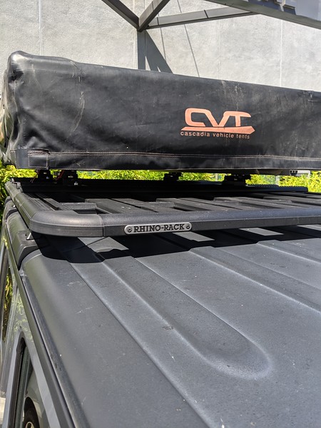

any suggestions for quick disconnect mounting? Tracks do not line up with Pioneer Platform long slats. Would require drilling. Want to have quick disconnect for on and off ease of use. Absolutely no room to get wrench or hand in to tighten with Roofnest brackets…any suggestions welcomed…

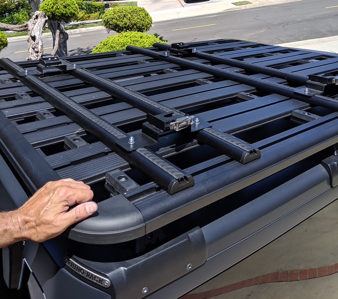

This is what I did when I ran into the same situation with my RTT and Pioneer Rack. I used 2 pairs of Rhino Rack accessory bars and a set of Frontrunner quick disconnect tent mounts. Certainly not the cheapest solution but it worked. I have a different tent now that lines up so I don't use this option anymore.
It does sit up a bit off the rack but it solved the issue. The other option is to just get the Frontrunner non quick release feet and just unbolt the feet from the accessory bars.
