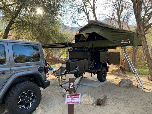

My mistake. My Expedition trailer is 2200 pounds dry, and likely close to 3000 pounds fully loaded with tent, awning, equipment, supplies and water. 13.5 feet long (including tongue) and 7 feet wide.Yes I was referring to the trailer
Nice rig.A few pics for reference if it helps.

That's really nice. How does it do on trails at that weightMy mistake. My Expedition trailer is 2200 pounds dry, and likely close to 3000 pounds fully loaded with tent, awning, equipment, supplies and water. 13.5 feet long (including tongue) and 7 feet wide.Yes I was referring to the trailer
My 2021 Rubicon JLU with factory towing package pulls it just fine, however I just picked up the Trailer in Phoenix 2/11/2022, and have only taking short trips. No problems on hills on regular roads. I'm not a "rock hopping" type of offroader, and got this trailer to get to places in the Sierra, east and west side that normal vehicles can't access. It has a 43 gallon water capacity, but I plan to not max that out unless I'm on a really long trip.That's really nice. How does it do on trails at that weight

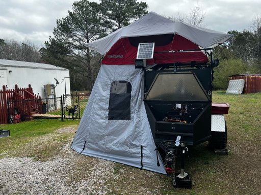

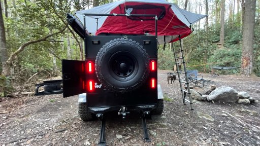

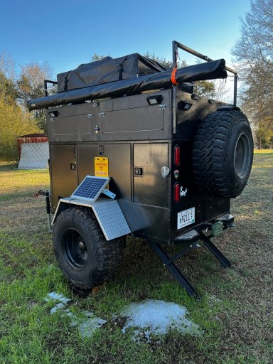

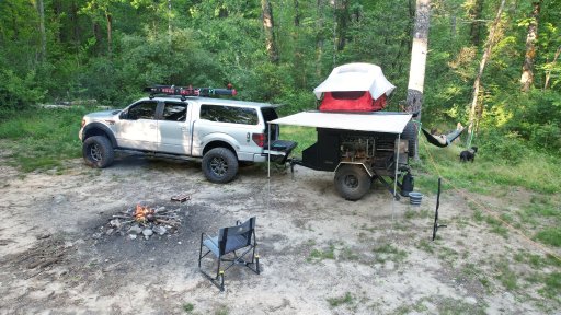

I hoping to keep my weight down around 1500lbs but I don't know yetMine is a heavily modified 4x6 originally purchased at tractor supply. It’s a whole lot easier to modify a registered trailer than to build one from scratch, then apply for a title, registration & license plate. The tent and rack weigh a little over 200 lbs. I added 200lbs of 2x tubing to the frame in order to strengthen it. I also added 5,000lb leaf springs atop a 3500 lb dexter ezlube axle. Yes, tis a shade overbuilt for the total weight of the trailer with all supplies & liquids on board at 1,500 lbs. It tows like a dream with 100lbs of tonge weight and goes anywhere the cruzer can go. View attachment 225730

RTT, battery, 5 gal fuel, spare tire, awning, 40qt fridge, base camp stove (the big one) 20lbs propane, small ladder, wheel chocks, foot locker full of odds and ends, axes, saws, etc., boulder solar panels, extra ground tent, sleeping bags, camp chair, totes up top with odds and ends ….I think that’s everything that stays on my trailer and it’s just over 1500 last time I weighed it. If I remember correctly 1530ish.I hoping to keep my weight down around 1500lbs but I don't know yetMine is a heavily modified 4x6 originally purchased at tractor supply. It’s a whole lot easier to modify a registered trailer than to build one from scratch, then apply for a title, registration & license plate. The tent and rack weigh a little over 200 lbs. I added 200lbs of 2x tubing to the frame in order to strengthen it. I also added 5,000lb leaf springs atop a 3500 lb dexter ezlube axle. Yes, tis a shade overbuilt for the total weight of the trailer with all supplies & liquids on board at 1,500 lbs. It tows like a dream with 100lbs of tonge weight and goes anywhere the cruzer can go. View attachment 225730
Yeah I want to keep most everything in the trailer and not the truckRTT, battery, 5 gal fuel, spare tire, awning, 40qt fridge, base camp stove (the big one) 20lbs propane, small ladder, wheel chocks, foot locker full of odds and ends, axes, saws, etc., boulder solar panels, extra ground tent, sleeping bags, camp chair, totes up top with odds and ends ….I think that’s everything that stays on my trailer and it’s just over 1500 last time I weighed it. If I remember correctly 1530ish.I hoping to keep my weight down around 1500lbs but I don't know yetMine is a heavily modified 4x6 originally purchased at tractor supply. It’s a whole lot easier to modify a registered trailer than to build one from scratch, then apply for a title, registration & license plate. The tent and rack weigh a little over 200 lbs. I added 200lbs of 2x tubing to the frame in order to strengthen it. I also added 5,000lb leaf springs atop a 3500 lb dexter ezlube axle. Yes, tis a shade overbuilt for the total weight of the trailer with all supplies & liquids on board at 1,500 lbs. It tows like a dream with 100lbs of tonge weight and goes anywhere the cruzer can go. View attachment 225730
If you plan on your water tank being on the trailer then obviously things will add up quick. Mine is only 8.5 gallons and I keep it on the truck. I would like to mount it to the trailer in the future. I think that tank full would be around 100#. So even still, I don’t think I would have to remove anything. Just rearrange for weight dist.
