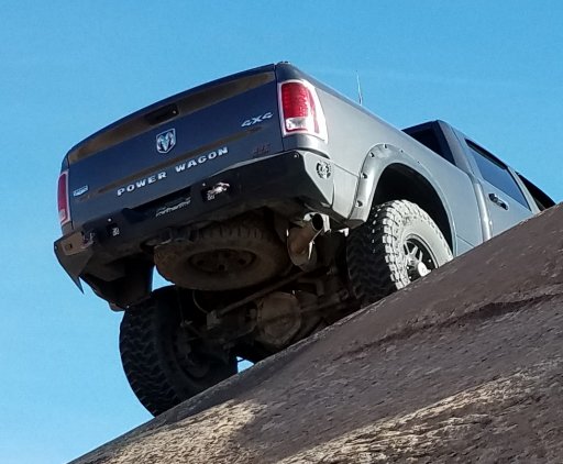

I love the ADD stuff! I have the HoneyBadger rear bumper and all of my Rigid Lighting has come from them. I got a chance to tour their shop back when they were much smaller 2012 if I remember right. I have been a loyal ADD fan since. Here is my ADD rear bumper.20170607_155703.jpg

I love the ADD stuff! I have the HoneyBadger rear bumper and all of my Rigid Lighting has come from them. I got a chance to tour their shop back when they were much smaller 2012 if I remember right. I have been a loyal ADD fan since. Here is my ADD rear bumper.View attachment 29457
I really like their stuff also, I have the Venom bumpers front and rear with Rigid lights. I just don't think I could pull the trigger on the roof rack that is no drill, because you have to get the chase rack also. You are looking at $5000 for both. It is just more than I would willing to spend. The Wilco rack is much cheaper at $1885, but does not look as good.
