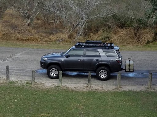

Prinsu. Love the way it follows the body lines and doesn't look as boxy as the others. I have my CVT RTT on top of it along with a CVT awning and mounts for Rotopax fuel and water. I could add mounts to the back or other side if need be as there is still room.

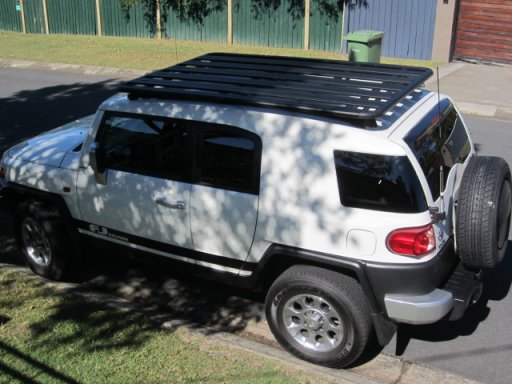

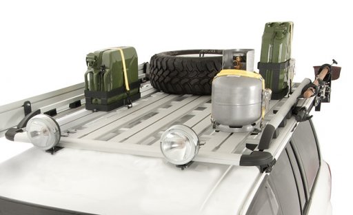

I just purchased a Rhino Rack Pioneer Platform rack. Should be here Monday. Looking forward to it. Aluminum, modular rails, T track, main difference from the Front Runner is that the wide slats go front to back, not side to side. Seems to be lower profile as well. There's a ton of attachments available too
