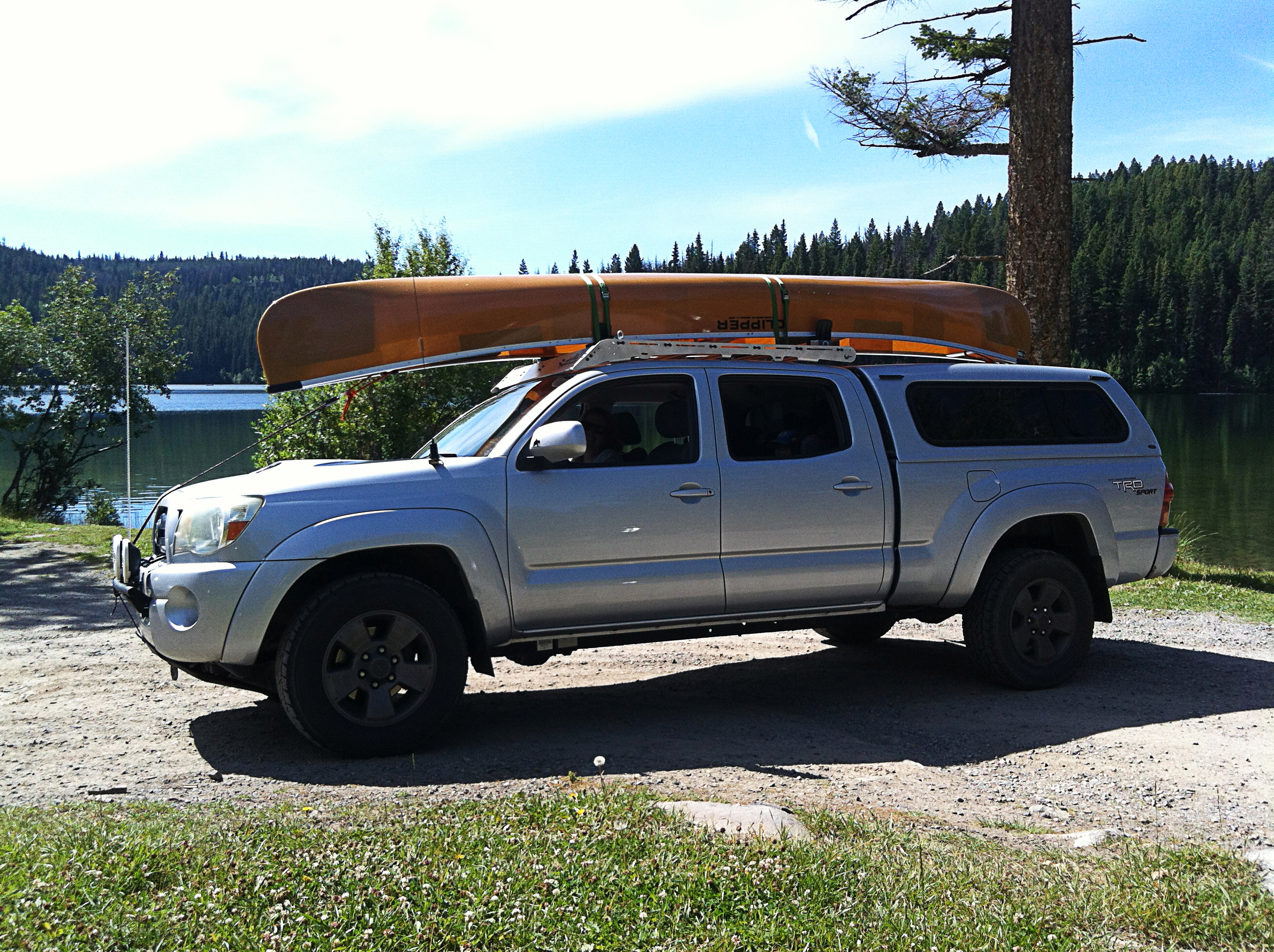

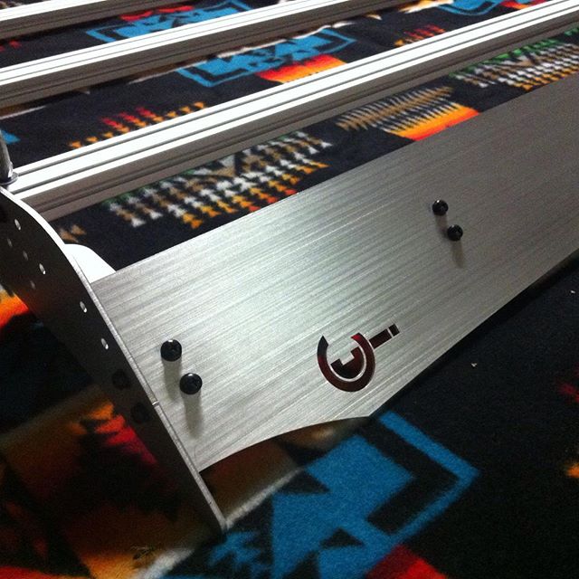

Prinsu here;
I went with clear anodized bars and raw aluminum sides, I didn't want to deal with chipping paint or anything like that.
The other huge plus to me was the modular design. I love that I can change the bars around, get more attachments, and even replace individual parts if needed.
The T-slot bars are super easy to make attachments for, any m8 carriage bolt fit right in.
I bought through a GB on Tacoworld - shipping was a lot better than the alternatives as well because the parts of the rack come in a 4ft box - some assembly required :smile:
Zach is also super to deal with, and he's just a truck guy like the rest of us, who came up with a really good idea and went with it.
