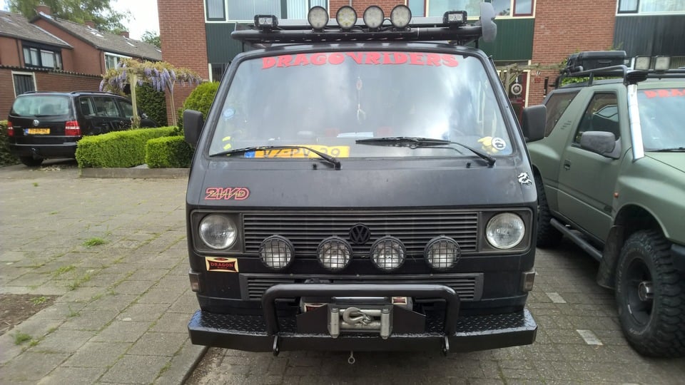

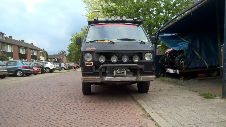

Well after we came back from Wales, work on the Van is the name of the game for the following two weeks. With Midsun we like to go of into France with our new interior and new bumper.
Yes the bumper which came of, I will replace that.

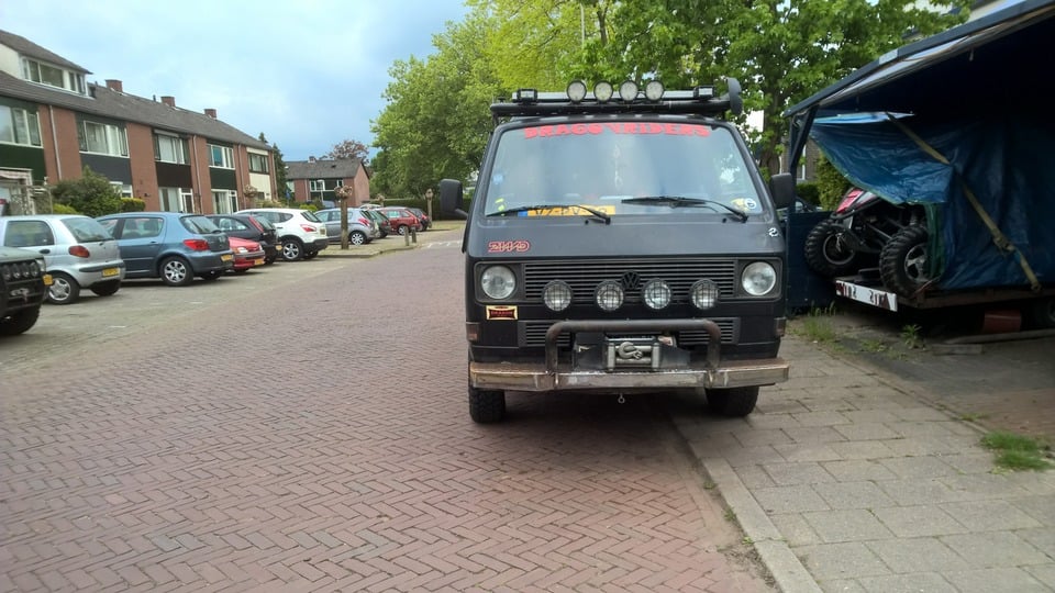

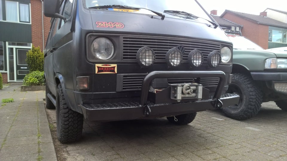

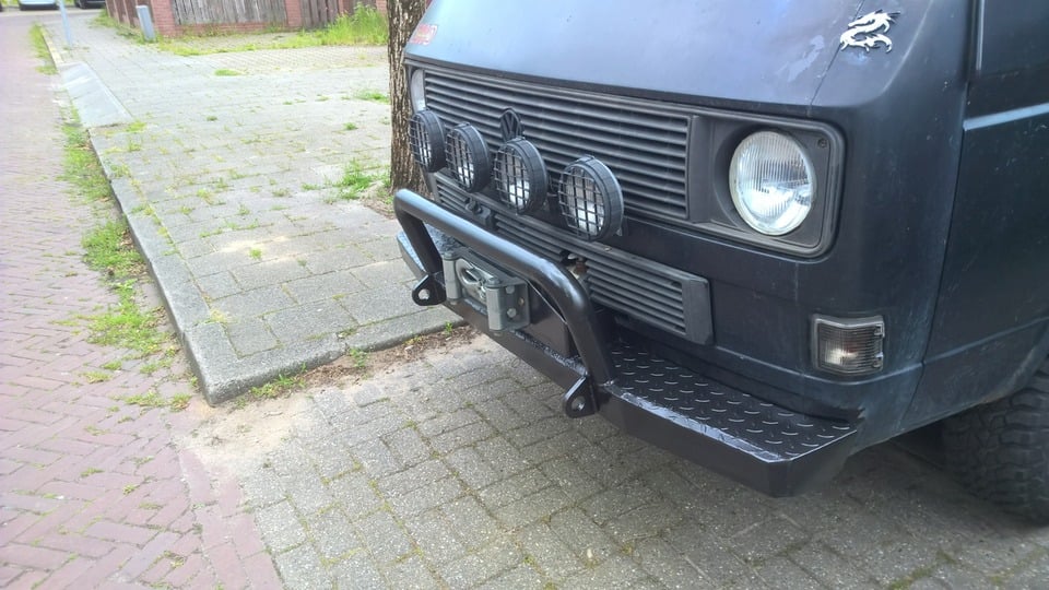

So, the first step of making the new bumper is making two new Tow hooks.
Then I need a new surface which goes on top. Some old teardrop plate does the trick.
A little bit of shape, so it wont be as rectangular.
So after all te preps, I started with welding in a tube from bottom to top, just to prevent the bumper to collaps when force is on the bumper
Then it was time to get serious
And then my welding machine said it was time to stop. Welded way to long for it. So, will go on tomorrow and Thursday.

Next step of the bumper story.
Today start with the front of the bumper. Well, as you can see, I start getting a bit to a almost novice level of skill.
Tomorrow we will try to close the bumper on the bottom. Then the sides and then...... we have to think about that. Ideas, Ideas.

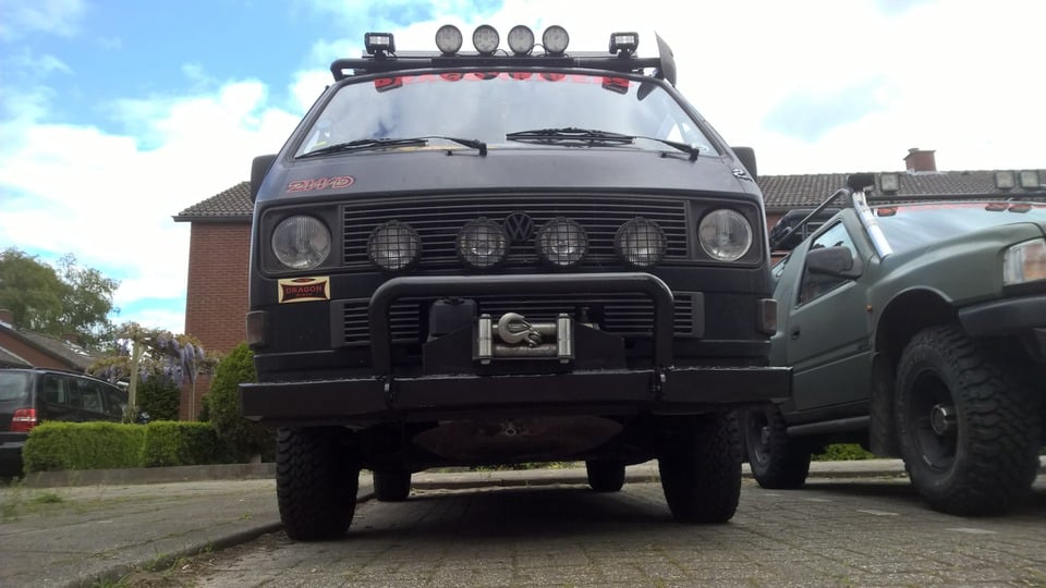

Well folks,
Back again and I worked again some time on the Bumper. Which isnt finished yet, because I ran out of cutting discs and the order I place is in delay. So, my Priority turned from Bumper to interior.
But first some pics of what I had done before I ran out.

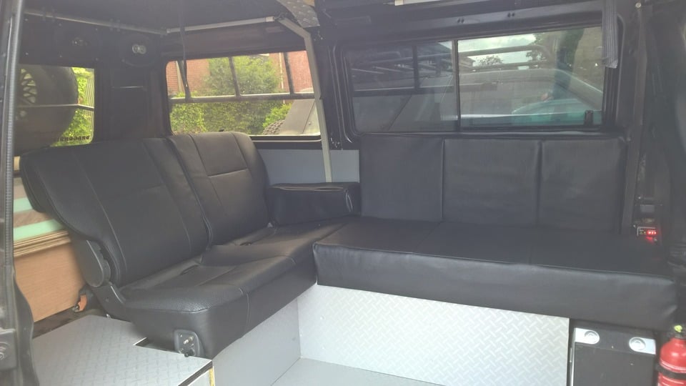

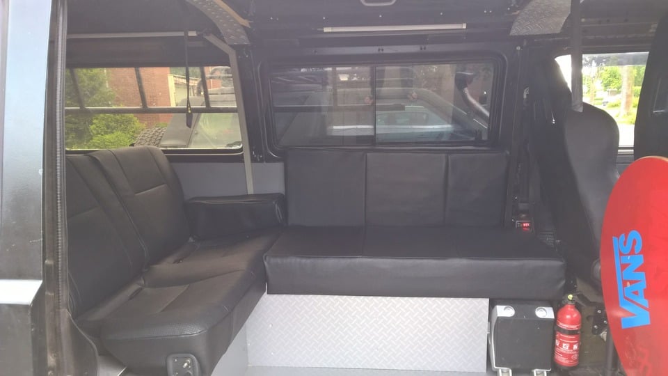

So, now the interior.
First everything out and a fresh layer of paint to start with.
Then it is time to put things in the van again. Not tight, as it has to come out to be painted and gets a kind of layer of "carpet".
Getting more in there.
And that is how one of the possibilities of a bed will be.
One inside the van.
And the other one will be half outside of the van. But that will be another story.
Which I still have to make and then write about it.

Well, I finished with the build of the interior. So, now I can take it all out, sand it and paint it. Then, rewiring the whole stuff.
After that, well, getting it all in there and finish that part.
Some last unfinished pictures
And the battery is protected and covered as well.

Anyway. Painted it, put a new vinyl floor in the van. Glued that vinyl flooring to the interior as well. Made the second seat in the same way as the back seat. And well, see for yourself.
Next step is making the kitchen corner, the bed, the Tailgate Tent, and finish the Bumper.
Will work on that in random order. And my girl Frederique does the sewing and will make the extra side cushions and the rear cushion. All in the same way.
It will look good I think. Iam very proud of my girl.
She and I, but mostly she will sew the Tailgate Tent.

Again some pictures. Little steps forward. Today we, Frederique and I, did some work on the interior. The seats are ready and just one arm cushion and then it is really done.
It looks good, as far as I am allowed to say so.
And I did the last part of the Bumper
And painted it today. Hammerite is the best.
