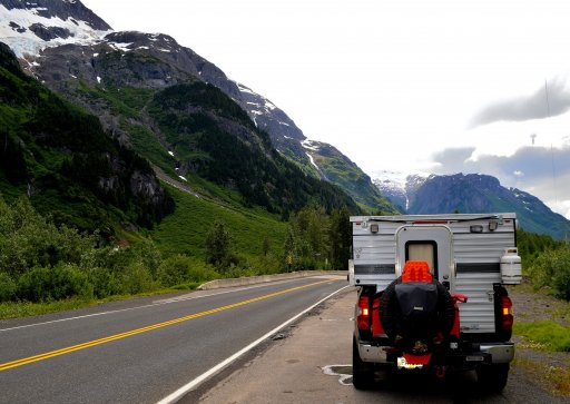

37032731_10155366540901637_8268672764836052992_n.jpg 37354288_10155380563101637_96823934539792384_o.jpg I have the Hitchgate on my truck. It was exactly what I was looking for. It is the offset model so it swings out completely to the side of the truck. If you have a tailgate, it allows you to open it. I have a dual fuel can holder, and Hi-Lift attachment on it (along with the trendy old Maxtrax and Trasharoo) I put a padlock through the pinlock hole in the evening, so someone can;t come along and close/latch the Hitchgate and lock us into our camper. The only downside is that this set-up prevents me/us from stealth camping in a parking lot with the Hitchgate closed. Though that really isn''t a concerns for me/us anyways.
trikebubble
2,522
Penticton, BC
1969
That looks like an ideal setup. Do you notice any rattling or anything of the sort from it? and do you mind saying how much it ran you?
No rattling or anything of the sort. It uses a wedge-locking system to keep it tight in the receiver hitch. I cut down a quad-cane from work and put it under the swing-away for added support when we are camped out for a longer stay. It's not really mandatory to do so, I just like to reduce stress on the hinge if the Hitchgate is left open for an extended timeframe.
I think I paid about $1K for the complete set-up. I didn't have a lot of options for the Tundra, so it was well worth it.
