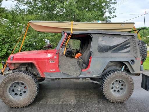

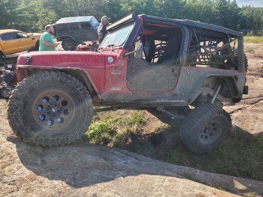

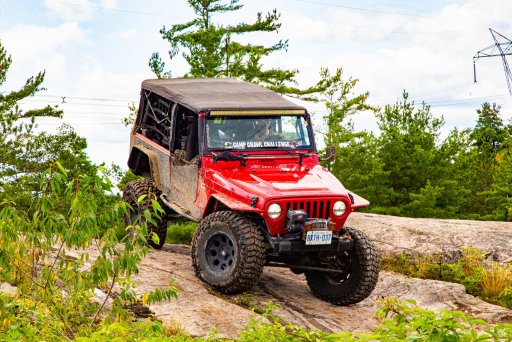

I run JK Rubicon axles in my LJ with 4.88s and 37s but I kinda wish I went 5.13s. My rear axle is trusted and I run a 3 link fron, upper triangulated 4 link rear, 6" springs, outboarfef the rear shocks .... and the tires still rub from time to time, and I have broke stub shafts and ujoints in the front.
It's not my daily driver and it's a pig on fuel but it hasn't stopped me from getting anywhere I point it lol.

You’ve made my point to the OP. Obviously you’ve dumped a crap ton of money into your beautiful LJ to make it into a trail worthy vehicle.
