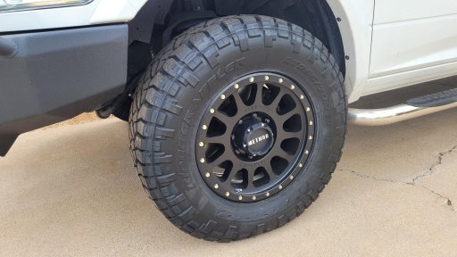

Currently have 275 x 60 x 20 General AT Grabbers on the truck with a 5 lug pattern. The biggest issue is no full size spare so I thought I'd upgrade the rim's while I was at it. Finding lots of rim's but not much with a five lug pattern.

Selling it isn't an option. The truck is my daily driver but also looking to set it up better for some offroad travel. No rock crawling or anything like that. The biggest issue is no full size spare so I thought I'd look into upgrading the wheels while I was at it. Currently running 275 x 60 x 20 General AT Grabbers with a 5 lug pattern. Basically looking for something better than the factory wheels. Budget would be $300ish per wheel.

Method Wheels makes a good product, my Offroad buddies all run Method Wheels. too rich for my blood, as I went with Vision Offroad Turbines on our Tacoma. If I had to do it again, I'd got with Method 301's. Good luck!

Another vote for Method wheels, for people who want to air down for off road, they have a few of their wheels with what they call 'bead grip' technology that has small ridges in the wheel flange to help keep the bead from slipping off at low pressure, pretty good compromise between a basic smooth wheel, and heavy expensive bead locks which are not typically DOT approved.
I have also been happy with Dirty Life wheels, Just got a set for the JK, love that not everyone has them so they look a bit different, and very affordable. Planning on a set for my Ram 3500 when i get around to doing a build on that.
I have found that the aftermarket wheels somtime have the valve stem a lot farther out (more exposed) than the stock wheels, the new tpms sensors I got on the last set would have had the valve stick out beyond the rim of the wheel, I managed to find a replacement valve stem for the new sensors that was almost an inch shorter (only sticks out about 3/4 inch from the mounting hole. far less likely to get snagged off road.

You can't go wrong with METHOD Race Wheels. This is the MR305NV HD. Also, check out the 704 Model...also similar in appearance as the one pictured below.
