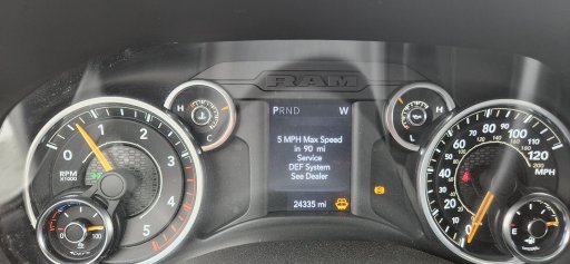

Do not recommend. I didn't want to piss in the Ram thread.
Previous 2019 Ram:
-split injection pump in half
-months later 2 injectors fail
-stranded twice
New Ram
-shifts smooth as burlap. Recall for trans. Aisen still shifts stinky.
-intake heater recall: "Don't park by house, will burn it down"
- aaaaaaaand will be stranded soon by DEF fail
That's just way too much in just 150,000 miles of Ram ownership. Arrgh.

Update. They fixed my Cummins.
Now the DEF guage drops quicker than my diesel fuel guage. And I leave a cool snail trail of DEF wherever I go.
Yay. i'M saVInG tEH enVRonmEnT. I aM.
