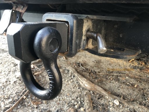

You might consider a frame mounted receiver hitch and one of these: D-Ring Shackle Mount Trailer Hitch:
Then, when you get the bumper, sell the frame-mounted hitch and keep the solid D-Ring, or sell both.
I'm putting a front mounted hitch on my van and have one of these to use as recovery point if needed.
A Class III Curt hitch receiver that fits Xterras goes for about $150 and this D-Ring is $35.00

Factor 55 hitchlink sounds like a good option for you.
Ah, yes. I did think of that, however I don't have a hitch receiver. Something I plan to rectify with a new bumper in about a year. I'm also aware that there are recovery point mods for the rear of an Xterra that require some bumper cutting.
Doing rear recovery mods at this point aren't really something I want to do if I can help it. That's why I was wondering if it is foolish to operate with only front recovery. If it is, then I'll rethink my year long plan.
A Class III Curt that fits Xterras goes for about $150.
Ohhh, I didn't know those existed.... lemmie do some research....
