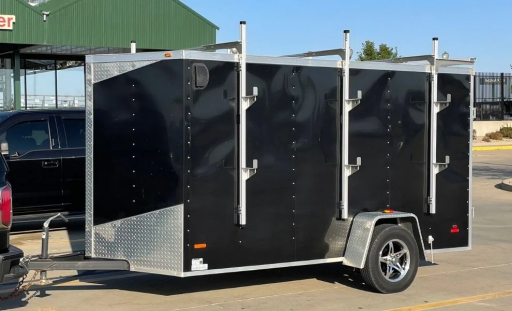

you can also make a rack that mounts to the side. instead of penetrating the roof, attach strut to the side of the trailer bolted thru the metal frame and have it go up past the roofline a couple inches and bolt a crossmember. do that 2 or 3 times and you have a nice rack with no roof penetrations. lots of options
This is very useful advice thank you. I've got an aluminum rack on the back half of the trailer, maybe I should use side brackets and just extend it to provide the hard points for mounting. I sure am getting more and more tempted to get a TIG welder the more I dig into this project.

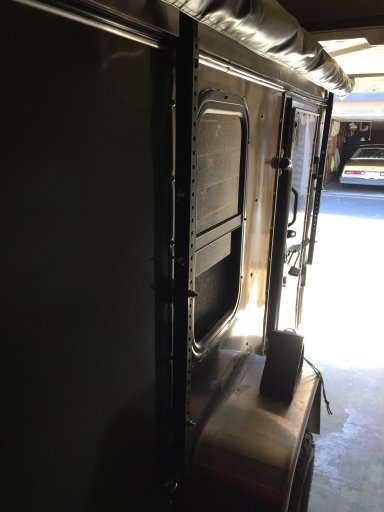

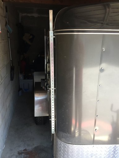

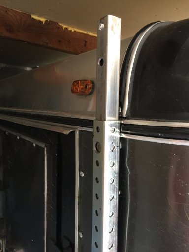

x2 on the side rack idea. i have a DIY "rack" that i made for my awning that i mounted on the side of the trailer in order to have an adjustable height awning. i used silicone caulking that is good for outside and colder temps to seal up the holes. i have long through bolts that go into the steel tube frame so that i'm getting the most sturdy attachment point that i can, which would help you with the solar panels as well.
