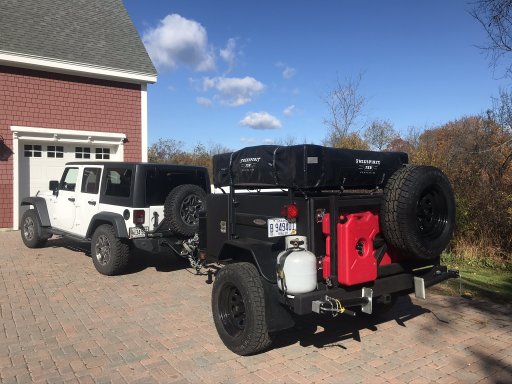

I have found these to be great mounts. Not cheap but they work very well. Powertank Propane mounts. They make them for 11lb and 5lb tanks.

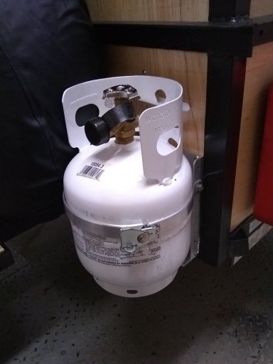

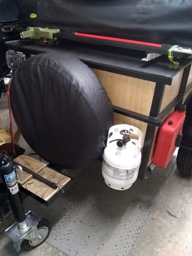

I knew eventually they would make one but 3 years ago I had to modify one to work. It’s been solid and securely mounted to my roof ever since. @Jeepsies you might recall it from mudfest 2018 haha.

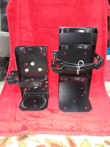

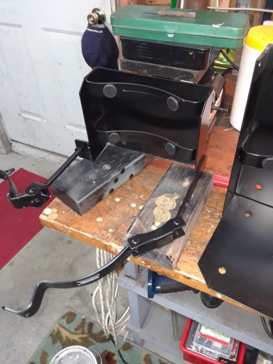

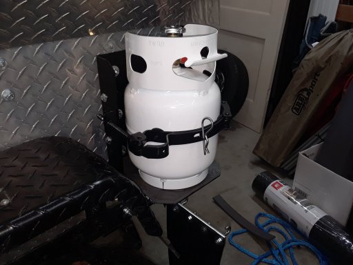

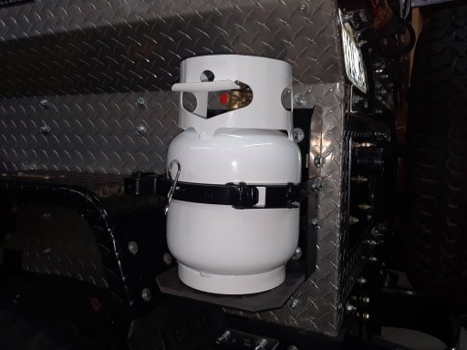

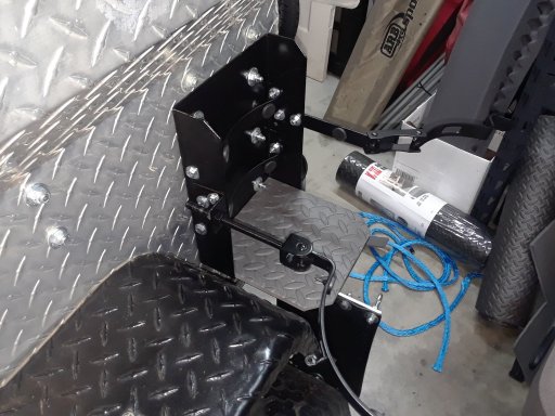

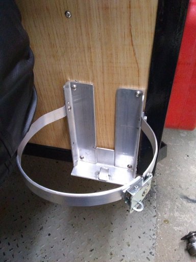

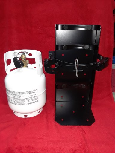

I took a fire extinguisher bracket and cut it down to hold my 5lb propane cylinder. The bracket is larger than one used for a 10lb CO2 cylinder (shown side-by-side below). The strap's tension is adjustable. Here's a write-up:
I've been very happy with it, and it holds the cylinder very securely.

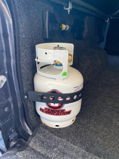

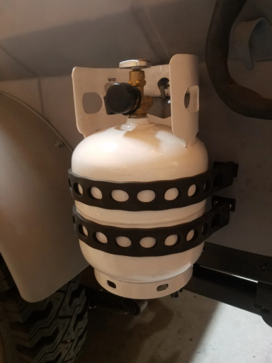

Found this online this is what i will be doing in my truck bed.
I Purchased the 5lb Tank online with Home Depot
Bought the Straps on E trailer, link below.
plan on cutting the strap in 2 as shown below. also attaching the link i found this on!
tank straps
trailer build out

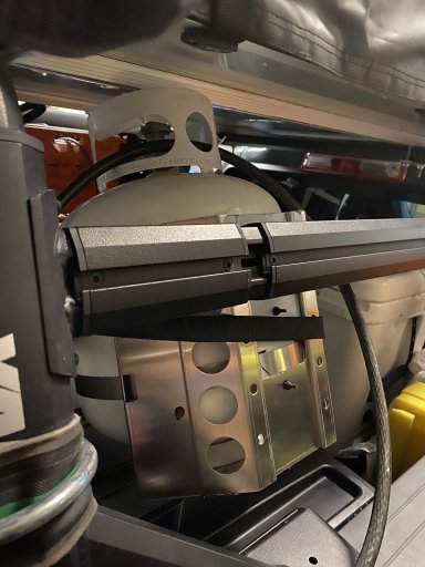

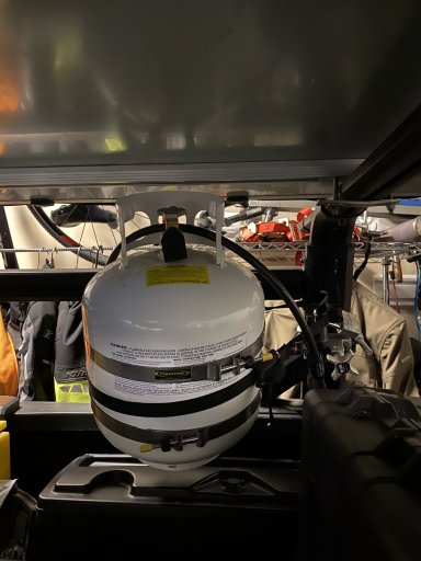

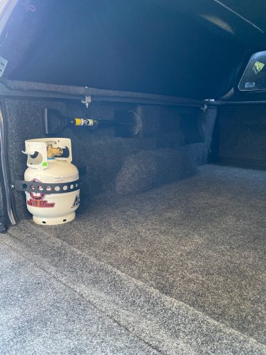

Quick Little Install, Found a good location, drilled some small pilot holes, fastened and that's all she wrote! nice and secure and easy to remove upon camp arrival/setup!

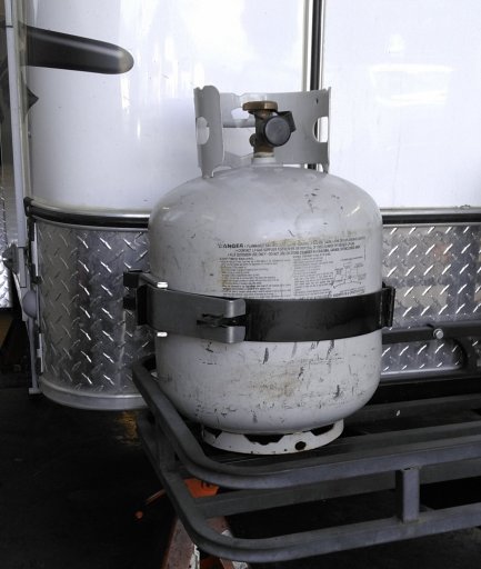

This is a bigger tank, but this is what I made out of a tank strap from a junk forklift at the scrap yard.
