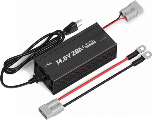

i have a 280ah lifepo4 battery and i use a smart charger made for the lifepo batteries and it is rated as 7 amps max input...so 7 amps and 120v from your generator is 840w, so i would say that yes, 1000w generator should handle your situation.
look at your charger rating and see if the max amp draw will put you over the 1000w of the generator.
you might could use the 12v output of the generator to charge the battery via a charge controller. not sure if a MPPT controller will operate off of a generator. i dont think the dc output of a generator will be high enough voltage for the MPPT controller to work properly, but might be worth looking into.
the smart charger i use is 14.6v and up to 20 amp output, so on a huge battery like the 400ah, i would definitely go with a good charger that will jam those electrons into the battery.

Find the charger for that answer. It's rough with LiFePo because you need a charger designed for it and I doubt you'll find one that'll do north of 60A at anything reasonable. 30-40A is way more common and that'll take you a solid 12+ hours or so from zero.

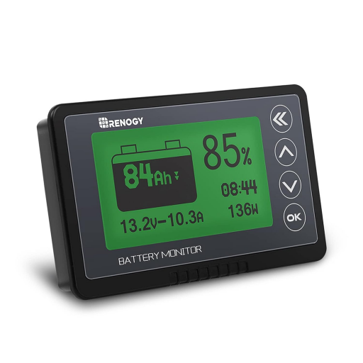

there are way too many variables to get accurate data without having some hard numbers to go off of...and that is going to be specific to your personal setup. i have 3 power stations i built and all of them have a battery monitor with a shunt. with the shunt wired in, you can get exact data on all the electrons going into the battery and going out. you can get a monitor as low as $30 or so on amazon. wire in the monitor and then run your fridge and monitor the data. you will get a live readout of watts used as they are being used. you can hear the compressor kick on and then look and see what the watt draw is during the cycle and so on and so on. the monitor will give you a constant readout of battery power remaining in percentage.
buy a monitor and you will always know what is going on with your battery. personally, i think a monitor is a great investment for such an expensive battery. a 400ah battery is between $600-900 depending on brand and a monitor is maybe 5% the cost of the battery

100 percent. I will be having a monitor installed in the frunk as well. I want a system where if we are off grid for 5-7 days our gear is all charged and the food is cold and fresh! I think the 400ah battery with inverter for our computer/phone charging will do it.
