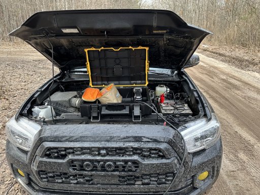

To mount the compressor I removed the two rear rubber feet and used the holes. I marked it on the bottom of the box and drilled through. I used a 10/32 nut and bolt to mount the rear. The two front feet are placed underneath the unit so I ended up drilling two holes on each side of the tank and used some sturdy nylon panduit zip ties. (I want to swap for metal zip ties). On the bottom side of the box I put a dab of silicone over the holes and around the bolts to keep the box waterproof. Also to make the unit fit I had to cut the top of the box to make enough room. It didn't seem to affect the durability too much. Not sure how the Milwaukee Packout or the Rigidboxes will fit the compressor.
That's the final product. I keep my tire repair stuff and my tire deflators in the bag that the compressor comes in. My plan will be to strap the box to the side of the bed on the drivers side in front of the wheel well. The DeWalt box fits nicely there and doesn't protrude out from the wheel arch in the bed.
