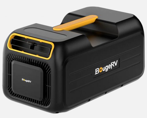

I was looking at those also. A couple of my friends have the zero breeze and gawd are those power hungry. The zero breeze mark 3 is rated at 5200 btu compared to BougeRVs 3500. The Bouge should have a bit less on power draw. One of my friends spent some time in 90 degree with high humidity and said the Zero Breeze worked well but was almost not enough. He is in a very well insulated trailer. I'm not sure how a tent would work out.
I do have experience with BougeRV's customer service. Quick response to my questions but I have the opinion they don't understand their product very well.
I have their water heater and I'll say this, everyone else's is last generation, theirs rocks. Hopfully their ac unit is the same quality.
