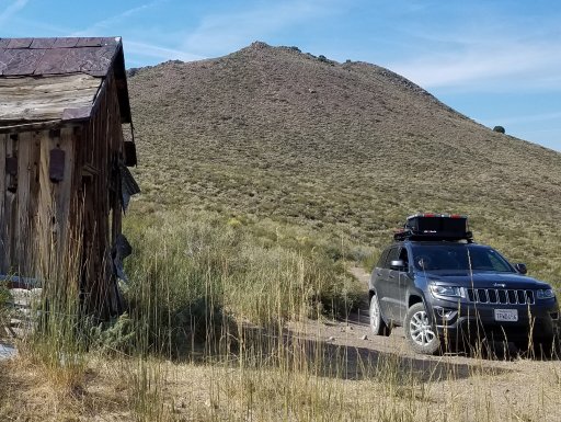

The GF and I have a medium sized dog and I put a roof rack on the WK2 for a lot of the stuff. It works well and allows us room in the back area in case we arrive somewhere late and want to just crash inside instead of setting up camp.
I looked at the receiver baskets, but often have out mt bikes on a hitch rack so that wouldn't work for us.
