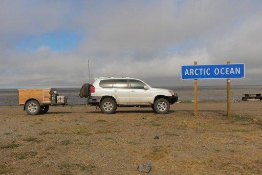

I would first find the vehicle you like to drive that carries the family and that will get you places you want to go.
Next I would buy or build a small trailer to haul the gear. ArmyRN started a thread here about Harbor Freight trailers and building them up for off road, it will give you ideas of what can be done (warning long thread). Mini Harbor Freight (type) Trailer Ultimate Build-Up Thread - JeepForum.com
I got lucky and some friends built me a frame and I made a box. I did two trips to Alaska and northern Canada with the trailer. Each trip I had 2-3 other people with me and there was no way I could of done the trip without the trailer, it carried all the gear. Jeep the trailer had one box on it and the GX had the new, stronger box on it, but the same trailer frame. The trailer is based off an M416, so it’s not very wide and easier to get around switchbacks. So far it has followed the tow vehicles wherever I have gone.
