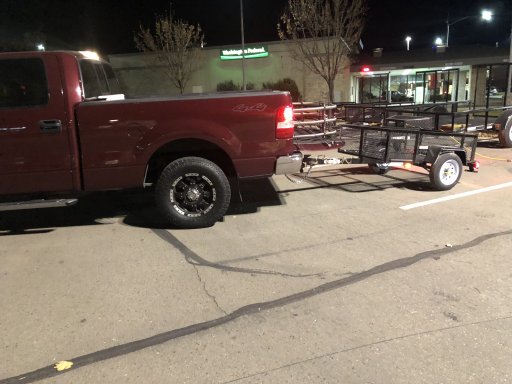

Step 1: Locate a 3x5 trailer that has been sitting at Lowe’s for a while, then talk the Lowe’s manager down from $479 to $350 by using cash and pointing out as many scratches and dents as possible. Buying in winter also helps.

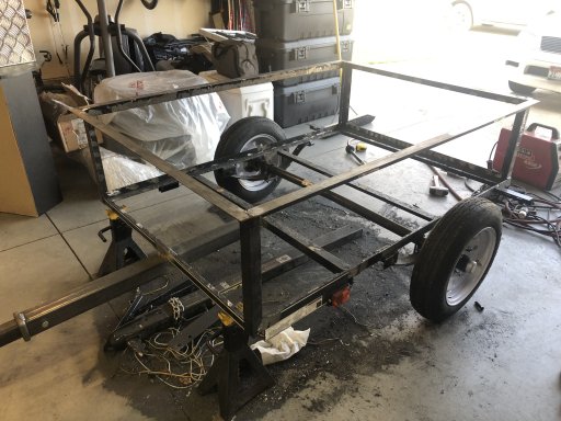

Step 2: Cut and grind off all the expanded sheet metal, and the fenders, and most of the angle iron uprights.
Step 3: Cut off the tongue.
Step 4: Weld on a Curt 36” 2x2 receiver tube.
*Wheel adapters/spacers are on the way. I aready have matching Mitsubishi Montero wheels, and new matching Cooper Discoverer AT3 tires in the same size as the Montero.

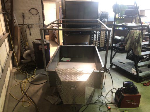

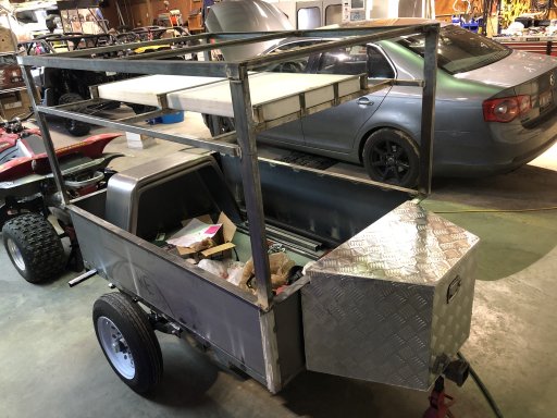

Plans are to use 1.5” angle iron, 1”x2” uprights, and 1” crossbars to make a perch for our 2 Road Showers, 4’ Lifetime table, 42”x48” Tepui roof top tent, and 4 X-Bull traction mats. Inside the trailer will be 3 XL Plano cases. On the tongue will be an aluminum diamond plate tongue box I just scored on Ebay for $90 shipped, which will hold the toolbag, compressor bag, and recovery equipment. This will leave the back of our Montero for our cooler, and the dog. In theory we could double stack the Plano cases and fit the cooler inside the trailer if needed. Will likely weld up some Jeep style fenders that we can step on, and will probably weld in a floor and sides. The more dirt we can keep out the better (hence the expanded sheet metal going bye-bye).

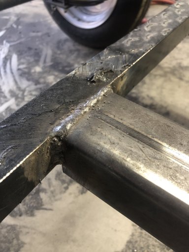

Found one corner was out of square (height-wise). Cut the old weld off, ground it down, adjusted the height, re-welded.

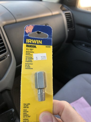

Removed a stripped hex bolt from a wheel adapter...

1. Axle flip
2. Removed the small leaf from the leaf spring pack
3. Welded in 2” center sleeve
4. Welded in rear hitch receiver
5. Welded up some parts of the underside that had not been welded from the manufacturer
I’m probably not building this the same way as others, and that’s okay... The key thing to remember is that this will be an ultralight 3x5 trailer with an extra long tongue for jack-knifing ability. No batteries, no solar, no fridge... just a very simple setup with roof top tent, 3 Plano cases, some toolbags, and a set of 4 X-Bulls.

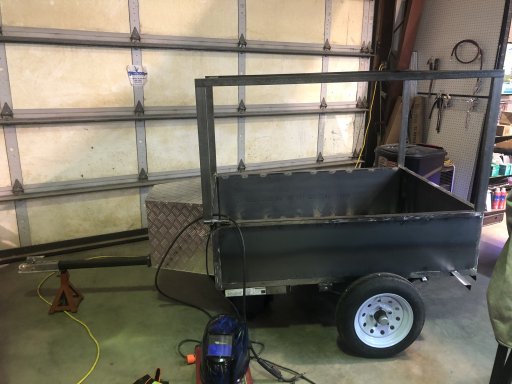

More progress... got the sides trimmed and spot welded in. Got a lot of the paint stripped off on the inside. For the grand finale: Found out the Mitsubishi Montero wheels are not going to fit... here are the specs:
15x8
6x139.7
+48 offset
I ordered 4” of adapters and spacers to move the wheels out, but I’m kinda over it. The cons are quickly outweighing the pros here.

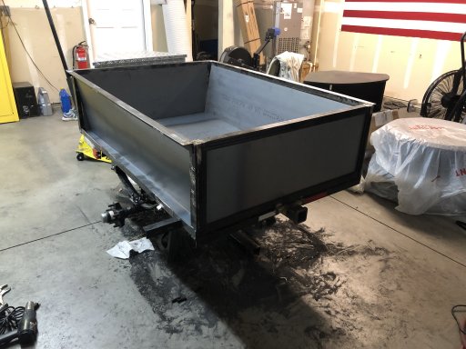

Purchased double-eye leaf springs today to avoid what was mentioned above... the saga never ends apparently... in another few days the only thing left of the original trailer will be some angle iron...

I'm loving this build...I have a 4x6 trailer of the same brand that I've had for like 13 years and am wanting to do pretty much the same that you are doing here, I've been brainstorming forever and it's nice to actually see you do what I've been trying to visualize! What gauge steel did you use for skinning the sides and bottom?
