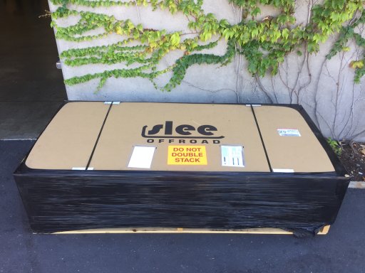

Next a call to Christo at Slee Offroad and a 100 series rear bumper was on it's way! The guys at work stayed after work to watch and help install and were blown away at the quality and ease of install of this great product.IMG_1921.JPG

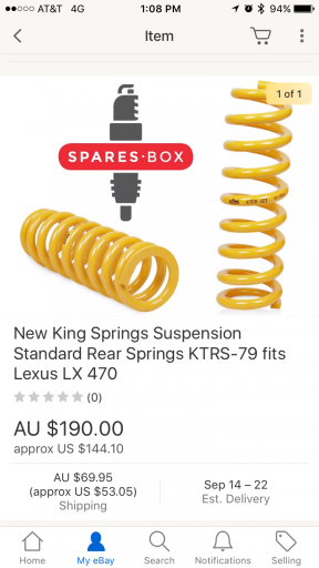

I found out about King Springs in Australia and the special rear coils they make for AHC equipped 100's. I ordered a set and they will be here Thursday the 15th. After installing these I will be able to loosen the front torsion bars back to specified pressures and the ride should be better.

Man i love that Slee Rear Bumper.
Your truck looks fantastic.

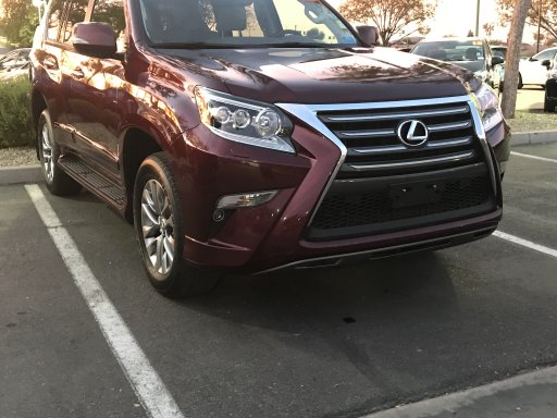

Nice looking rig. I just got my lexus gx460. I am just curious what kind of skid plates do you use for lx 470.
Thanks! I don't have any special skid plates, just the factory ones! I actually hadn't thought about upgrading...until now!! ;)
Let's see some photos of your new rig!

Very nice! I’m interested to hear about your King spring experience. I believe I’m on the verge of needing to freshen my AHC system.
The King Springs are doing their job and allowing us to pack up the rig and still maintain the ability to to through the different height modes when needed, normal height around town and raising it when approaching the trailhead!
We both really enjoy the AHC, but also the AVS "Active Variable Suspension" as we can change the ride to comfort on poor pothole bumpy city streets to sport on windy mountain roads.
I find with the stiffer LC100 torsion bars and the King rear springs and the program set to just one tick below "Sport" it mimics the other Cruisers I've owned with Old Man Emu Suspension.
