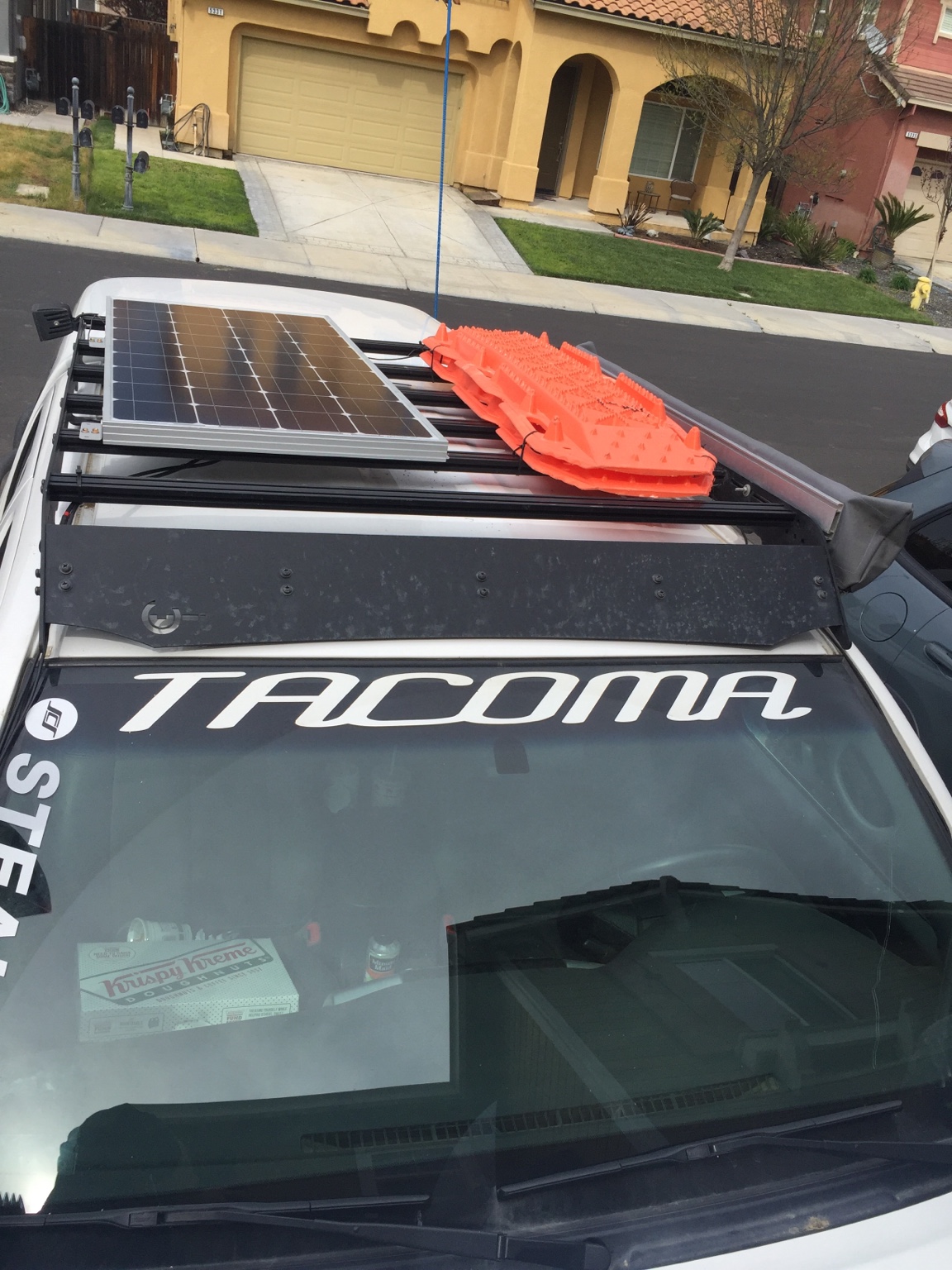

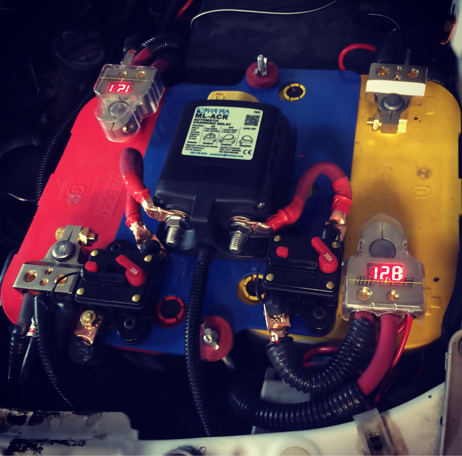

I use Optima Yellowtop as my main battery and it works awesome. I got it about a year ago and have had absolutely no issues with it. I know they moved production to Mexico, which sucks, but there is this slightly exaggerated stereotype they just suck now which they really don't. I had a friend, who is an auto parts manager for a popular online store, he told me its rare they get the Optima batteries get returned. The whole Optima/Mexico stance is usually blown way out of proportion. I run a VMAX 60ah AGM Deep Cycle (made in USA) for my auxiliary setup and its a really good battery as well.
