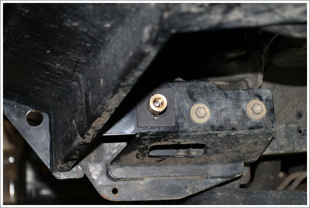

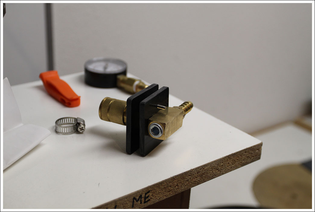

My 4Runner has front and rear air chucks so that I don't need a long hose to fill the tires. Both chucks are mounted under the bumper where they are easy to access, protected from rocks, and don't get too much spray from the tires. I put rubber caps over them to keep out dirt and grime.
I'd recommend putting a ball valve on the compressor side of the longest run so you can "turn off" that hose if it gets a hole. For example, on my truck the compressor is mounted in the back so the hose to the rear chuck is just 2-3 feet, but the hose to the front chuck is 10+ feet. One time on a trip near Mono Lake I blew a hole in the front air line and had to do emergency re-plumbing. Since then I've added a valve on the front air line that so if it gets damaged again I can just shut it off.
