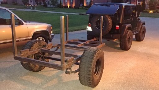

I chose a box trailer with an RTT. The 2 things drove me crazy when roughing it were no showers and food in the water in the ice chest. Those 2 things will not be a problem. I have a 21 gallon water tank on demand warm water shower an a 12v fridge.
I bought most of my steel in late December 2019. The main frame is 2x3 11ga, .120" and everything above is 2x2 14ga, .075". The floor and front of the box is 16ga and the sides and roof are 20ga. I want to keep weight down so I am not using quite as much tubing as some.
The boxes outer dimensions are 48"x80"x35" so the actual will be 2" less each wall and roof. I came up with those numbers to fit the footprint of the RTT and keep the overall height one inch lower than the roof of the tow vehicle. It also has a small platform that is about 48"x22". I have most of it figured out, but a few thing I have not decided their home.
Suspension currently is leaf springs from a Chevy Colorado, Monroe trailer shocks and a 3500# Dexter axle with brakes controlled by a Tekonsha P3 brake controller.
Here are a few pics so far. The last picture shows the stove extension folded flat for storage and without the wood. The slide is 44" and about 1/2 way out in the picture. When the slide is all the way in it is very close to the water tank.
