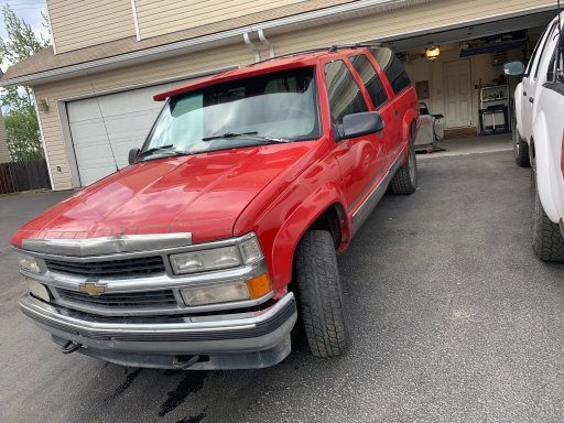

I finally found an incarnation of my dream vehicle last week at public auction, no less. Its a 1995 Chevy Suburban K2500 that includes: 7.4 TBI motor, 4L80E transmission, 241 transfer case, 4.10 gears front and rear, and seating for up to 9 people! I was looking for a square body one but up here in Alaska, they are literal rust buckets or priced way too high. A GMT 800 was also on my radar but they are hard to find in the 3/4 ton class. For the price I paid for this, its a steal. The previous owner wasn't the cleanest person ever clearly and didn't know much about engine maintenance either. Guess I got my work cut out for me. A 12 valve cummins or 6.0 LS swap is likely in this things future once the old 454 decides to die. I'll try to keep up with this thread as I perform upgrades, maintenance, and take it on trips.

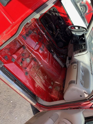

Had it delivered May 16th and immediately went to work. Cleaned up the interior real good, ripped out most of the old carpet and plan to replace it all with vinyl floor. Topped off the coolant, changed the oil, plugs, wires, checked the rotor and cap, removed most of the interior behind the front seat and began the process of scrubbing, vacuuming, sanitizing, and brushing every nook/cranny/surface I could reach. It currently runs like it has a vacuum leak or something. I'm fairly certain its running rich. If anyone has any sound advice on how to get this thing running like a champ, I'm all ears.
More will be added as I go I'm sure.

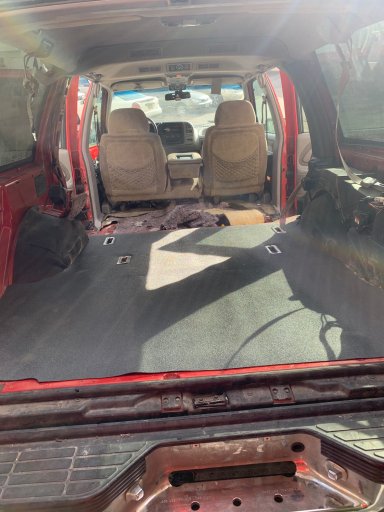

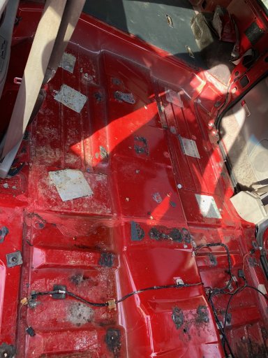

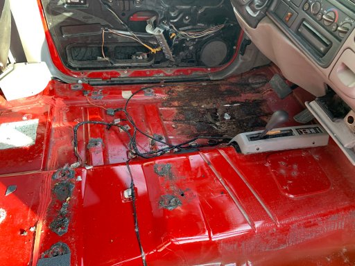

Few more updates;
finished pulling out the rest of the interior that needs replaced or cleaned. Found a pretty decent sized hole in my driver's floor board. Just another thing to fix I suppose. Some more sensors and other misc. parts came in today, which will get put in once I get all the rest. Managed to get the cargo area vinyl flooring in and secured.

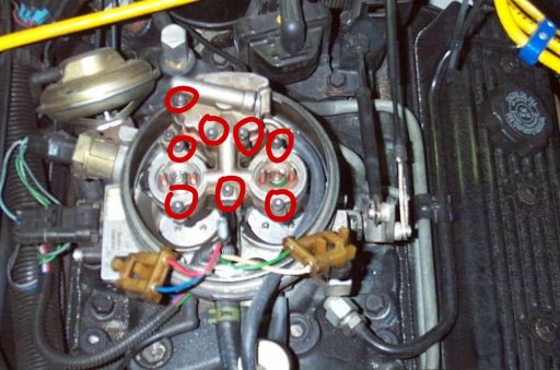

Nice rig. For getting it running nice, I would change out the fuel pressure regulator in the TBI. The spring inside rusts away leaving you with a rich mixture.
Funny you mention that. I'm currently having issues with it running rich. I can't seem to find any info on a fuel pressure regulator for the tbi unit. Any info you can provide on that?

The fuel pressure regulator is in the tbi body. Pretty easy to change just remove the screws from the top and replace the spring, diaphragm and gaskets. I circled the screws in the picture. There are 4 more On the bottom side for the diaphragm and spring that you can get after removing the cap from the tbi unit. The replacement parts can be sourced from any parts store.

I was able to find that spring and associated pieces but everything in there looked fairly new and the spring had plenty of spring left in it. Put new connectors on the fuel injectors, new o2 sensor, coolant temp sensor, and idle air control valve. Still running rich. I get dark exhaust smoke if i give it throttle after a cold start. Running out of ideas on how to get this rich fuel mixture fixed.
Edit: Played around with the EGR a bit, not sure if i have a vacuum leak or not as spraying starting fluid all over the vacuum lines didn't affect anything. The line coming from the evap canister to the throttle body looks like someone pieced it together with small lengths of tubing to make it work. Not sure if that would affect anything. I let the truck run for about 15 minutes and it idled pretty well, the running rich smell mostly went away but now it smells like a bad cat or none at all on the exhaust. On the floor pan replacement, nobody online has any available for the driver's side until like July. Guess i'll be putting in a temporary fix until I can get the proper part for it. I'm open to ideas for that as well but right now my plan is to cut the weak rust bits out and 'sandwich' 2 pieces of sheet metal, one underneath and one on top of the floor, and use some gasket maker or something similar plus some flat head bolts to keep it together. I don't have metal work tools or welding stuff available otherwise I'd make a more permanent fix myself.

That sounds like a reasonable thing. As for the cats, I don't know. I'll have to take a closer look but it doesn't affect drivability so far. There's certainly an exhaust leak though somewhere before the muffler. The floorboard fix came out good. Use rivets to attach it to the existing good sheet metal. Sprayed underbody coating on the bottom and sealed it up on the inside. It was a pain in the behind to do alone but got it done and it looks good too. Started getting the interior back in too. I'll post pics later.

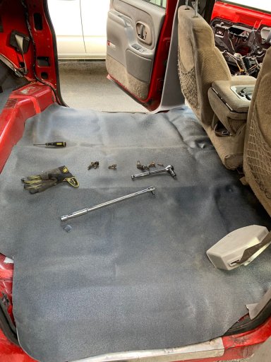

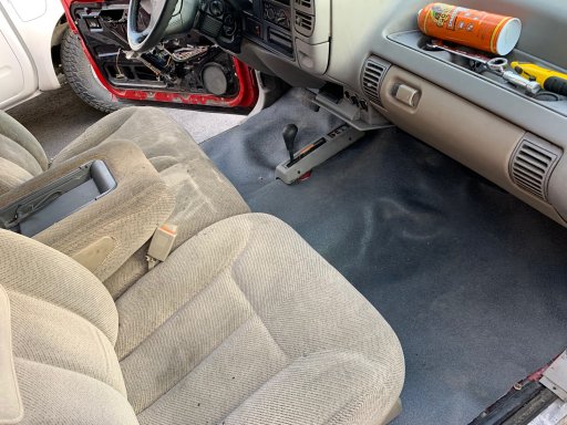

Not a huge update but got some more work done on the interior. It's now fully drive-able and more clean and comfy to be in. Anyone interested in installing vinyl carpet yourself, I recommend doing it on a nice warm day so the vinyl conforms to your floor better. I'm still fighting it and even with adhesive, it doesn't stay down very well. Also replaced the multifunction/turn signal stalk. That was a PIA but it needed it. Turned out I was missing the hazard relay under the dash but now i got a nice clean turn signal thing at least. About another month and I should be able to take this thing out and about and not just little trips in town. Can't wait to fill up the gas tank :sob:
