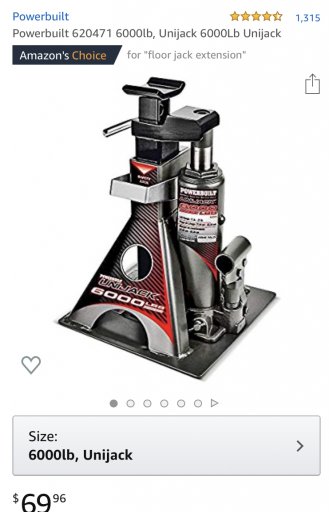

Personally I would rather carry a bottle jack and a come along over a hi lift , takes up half the space and quicker . But everybody has their preference. In my entire time of going off roading There has probably been only five times where a highlift was needed and all of those were out rock crawling.

We can agree to disagree, but a good come-along and a decent bottle jack will cost as much as a fully-outfitted hi-lift setup (with winching kit and lift-mate), weight about the same, and be objectively less versatile.

I'm with you on that one!
