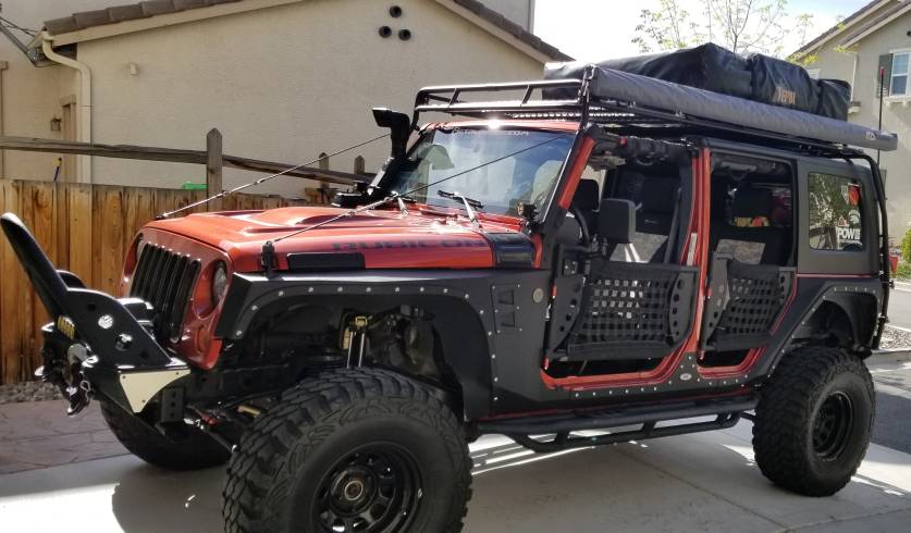

whoa,,, that's a $3,000 kit.. Hmmm, guessing you are attempting to do the same as I attempted to do with 2 jeeps over the course of 12 years. Make them cruiser like. That IS a nice rig, but is it street legal? It sure wouldn't be in most states. BTW,, even the best suspensions cannot change the laws of physics. It may feel solid as a brick but it will still go over. Be careful, be safe ! peace out
