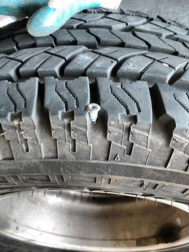

I've plugged tires with screws/nails in similar locations with no issue. The liability of the repair is what causes most shops to err on the side of being overly cautious. The only real issue I could see is if you air down you might stress the repair. Other than that there is a lot of tread left and without a warranty I'd fix it.

I would plug that and have no worries. I also would heat the repair area and the gooey plug so it oozes into all the little places.

Plug it. Having seen the research on it, I'm not convinced the "liability" line they feed you isn't an attempt to sell a tire. If you google and look for independent testing on this kind of thing, it's negligible in regards to safety. We used to plug sidewalls on ATV/UTVs but I think that's where I would draw that line. You shouldn't use a plug in a sidewall, but otherwise you should be fine.

Plug it and it'll be fine.

I've plugged hundreds of tires within the thread area. When you get into the shoulder area or side wall of the tire you're outside the plies of the tire and plugs typically will not hold in those areas. I only use vulcanizing or "gooey" type plugs rather than the type of plug that resembles a fishing lure or rubber worm. After you plug the area, cut off any plug that's over the tread depth, air back up and check with dish soap to verify no leaks. I would recommend taking a 20-30 minute drive to heat up the tire which helps set the plug.

But like many others have said, I wouldn't think twice about tossing a plug in that thing and rolling as is. Worst case I could see would be a slow leak continuing. In that case I liked the idea of finding a smaller shop that would patch it for you.

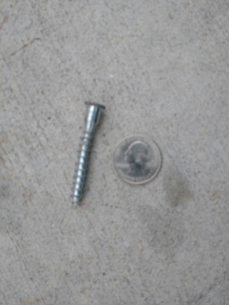

Went ahead and plugged it today with rubber cement. Let's see how long it lasts.
For the spare tire, I didn't want to use it since it didn't match the set of Geolanders AT/S I bought. I was trying to save money so I bought a Primwell AT tire. I figured I never got a flat before so I didn't care if the spare matched the set.
Here's the screw that I pulled out of the tire.
