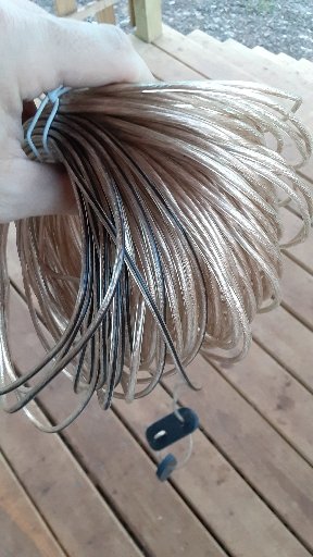

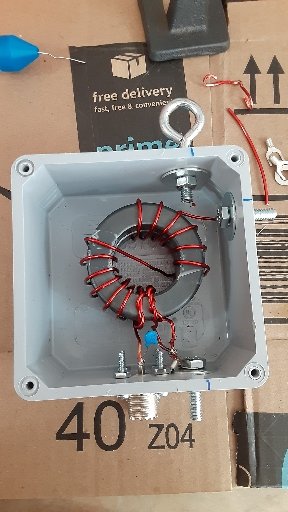

Built an 80m end fed half wave antenna over the holiday weekend that covers 8 bands 10m-80m, built the 49:1 unun transformer as well. It was a fun little project and I can't wait to set it up and do some field ops. At 134'+ I will need a lot of room to set up. This is the 3rd HF antenna I have built and it's nice to have options, which include a 20m/40m fan dipole and a 6/10/15/20/40m linked dipole.
Set it up as an inverted V as it would be the easiest to set up especially portable.
Started out with a counterpoise and no choke, tried counterpoise and choke, and finally settled on no counterpoise and a choke as I got the best numbers across all of the bands with that configuration. I tried it horizontal as well and saw an improvement on 80m and 30m but other bands got worse.
