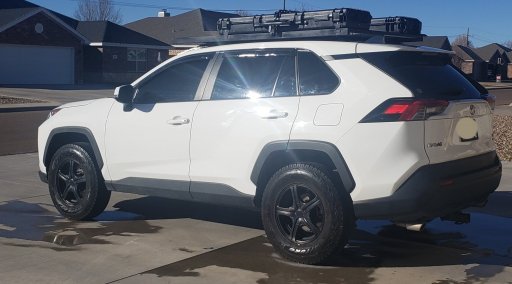

In my instance, if you zoom in, you can see a couple of brackets I welded onto the sides of my roof rack to hold the cases. I also made custom U-bolts that wrap under the bars and come up through the bottom of the cases. Over the top is a welded-on chain that locks down to the outside of the rails.
I park in my garage at night, and on a military installation during the day, so I am not too worried about thieves except for the occasional extended Walmart run. Still, a thief would have to almost fully destroy the cases (as opposed to simply snipping the plastic around lock holes or cutting a tie-down to steal the cases entirely) to get much out of of them.
I have all my recovery gear in one, and the other is empty for travel storage.

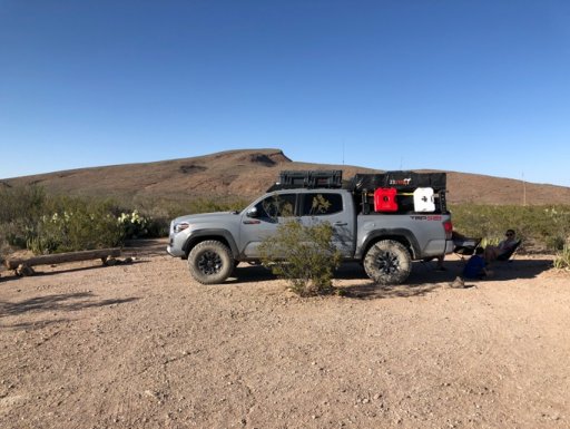

I drilled holes in my Roam box. 6- 1/4” with fender washers and rubber washer(for waterproofing).
