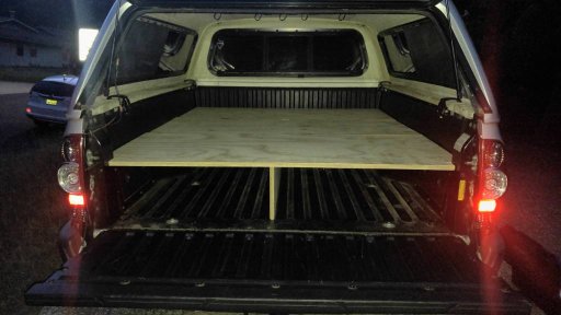

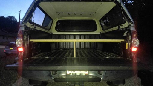

I built a simple/cheap drawer system for my Taco and wanted to chip in. My Gen 2 (2013) has a lip around the bed that is the same height as the wheel well (about 9")
It also has notches the height of a 1x6 (I can measure when I get home). So we have 3x 2 ft sections 3/4" ply the width of the bed, 2x 1x6 the width of the bed, and one support piece up the middle the length of the bed with notches cut out for the 1x6s. Pretty easy, all in all less than $100. We also got drawers that go under beds to slide under the platform for gear.
Attached some pics of it without any loaded gear. Should work well better for needing to take it out than the huge deck systems.20171002_193612.jpeg20171002_193619.jpeg
Attached some pics of it without any loaded gear. Should work well better for needing to take it out than the huge deck systems.View attachment 73481View attachment 73482
Thanks for the pics, I am going to build a real simple one as well. I am going to only run a single drawer and riff off of the latest overland bound video build. .
