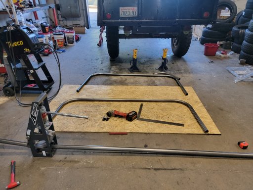

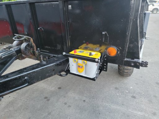

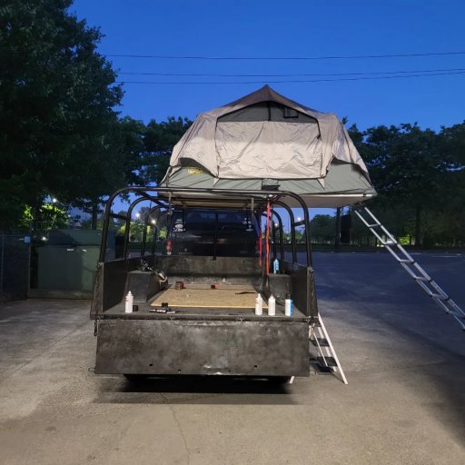

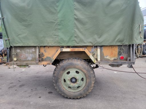

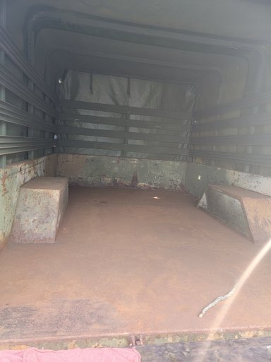

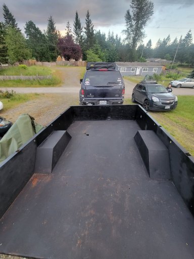

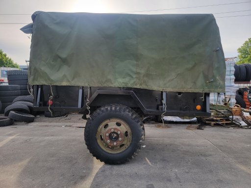

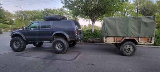

Purchased the trailer a month ago knowing I wanted to build it for overlanding. I started by removing all the old paint and then priming it next step was to get it painted. Ordered up my metal for the new walls and roof ordered water tank, hot water heater, water pump, battery brackets for the frame.

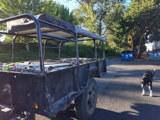

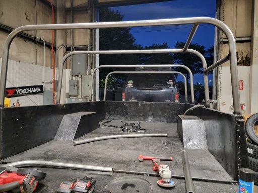

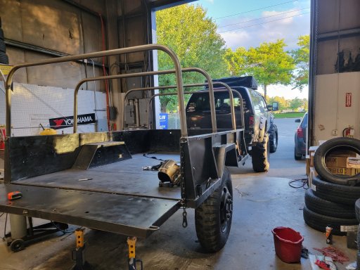

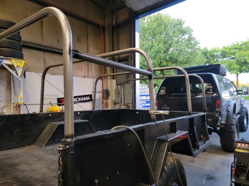

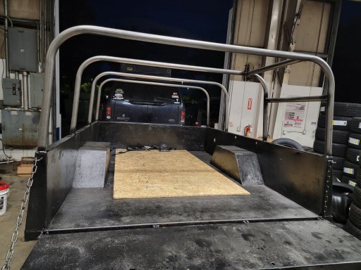

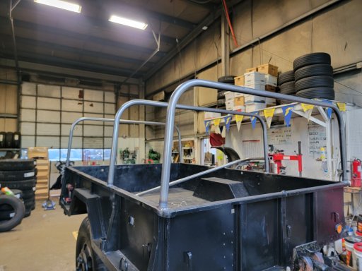

Got started on bending the new walls and roof welded them up to the bed need more tubing notched for all the cross supports then next step is to wall it in place the side windows mount the roof top tent.
Still need to buy mounts for the propane tanks and flooring for it. One small step at a time I guess

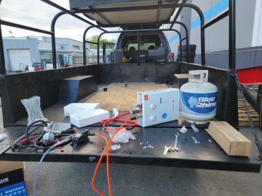

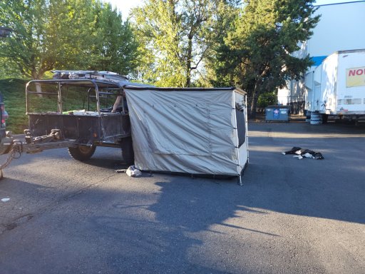

Here is the current state of the trailer build adding a 15 gallon fresh water tank for the hot water heater and shower.
