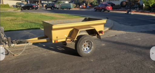

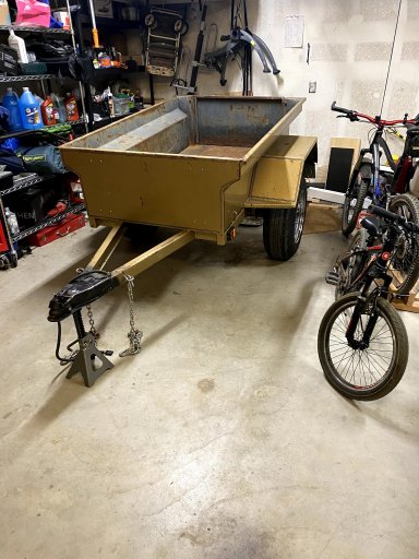

I just picked up an old Jeep style trailer (M416?) and it has no spare tire. It has a rare trailer wheel size\pattern of 15" with 5x5.5 lug pattern. Ideally, I wanted to run the same tires as my vehicle which is a 2019 Subaru Forester which is running 235/60R18 Falken Wildpeak A/T Trail which is rated as XL load but doing some reading many people are against running P or even LT tires on trailers but I don't how much difference will it make on my small trailer, it's probably around 500lbs empty and I hope not exceeding 1000-1250lbs when loaded. I'm not planning on going rock crawling with it (It's being towed by a Subaru...) but we do drive occasionally on remote dirt and rocky roads and trails so I'm concerned about how well standard trailer tires will do in such an environment, not getting flats... The current two tires also seem a bit old, plenty of thread but starting to crack\dry rot so I'm going to need 3 tires.
Trying to decide if I should just get a matching spare (which I found on eBay for 100$ wheel only) and install ST trailer tires, or get adapters to match the Foresters pattern and buy Forester wheels, but that is questionable as the trailer hub diameter is larger than Forester wheel bore size, the spacer will need to be at least 2" to clear the hub.
Or buy 3 matching Jeep wheels and LT tires.
The plan for the trailer is hauling some yard waste every once in a while and building it into an overland trailer with RTT for remote dirt roads and mild offroading (again, Subaru).
What do you guys think?
Seem like most here are going for LT tires.IMG_5857.jpgIMG_5858.jpgScreen Shot 2020-11-02 at 9.01.09 PM.png
