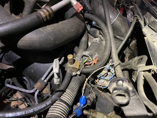

looking for a fuel pressure test port fitting
Matt Hixson
1,415
Big Lake, WA, USA
Matt
Hixson
25367
KJ7FZJ
My 1996 Hummer (GM 6.5 TD) came with this brass fitting in its fuel line for attaching a fuel pressure tester. Does anyone know where I can find another one of these?
Thanks,
-Matt
hrichard
Off-Road Ranger III
2,381
Camden, DE, USA
HARRY
RICHARD
47651
KC3UVV
You should be able to get a schrader valve with 1/8 npt threads on the other side and use a 1/8 npt female by barb by barb T. At least that would be my best scenario on replicating that without a lot of research
BasketCaseTech
Expedition Master III
2,735
Spokane, WA, USA
jonathon
Wiedmer
47405
WRYM477 GMRS
I'm not familiar with that exact fitting, and hard to tell the type of fitting with the cap on, but it kind of looks like a high pressure R-12 refrigerant fitting maybe? Either way if it were me I would change it over to a more industry standard connector like a Compucheck test port fitting.
