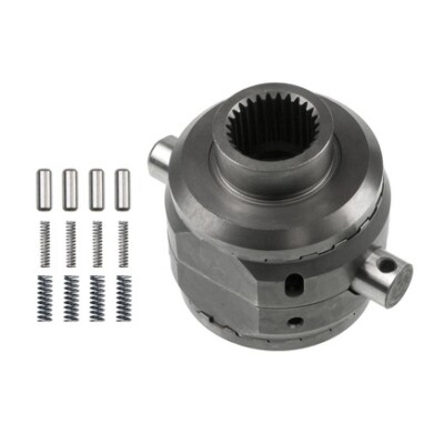

I am looking to install a front locker in my 2000 Durango, or at least a bit more information other than the info in my glovebox. So far all I know is, the front differential is cross compatible with the same year Dakota, and it is a 3.55 ratio "limited-slip." The Durango seems to be a more uncommon offroader, and it seems to be a bit more difficult to find a clear answer on if there is even a locker compatible for the front diff...
A few notes on my Durango, it experienced a side impact about 3 or 4 years ago, and when I put the Durango in 4WD, it acts like it has a locker, as the front tires APPEAR to be locked together when doing a very tight turn only in 4WD. Is that normal? I haven't seen information to indicate if it does have a locker from the factory! It leads me to believe that there may be something going on with the spider gears.
I was thinking about just installing a lunchbox locker, as it's more affordable for my wallet, and the simple construction leads me to believe that they are very reliable. If I had the money, I would prefer an OX locker.
I also don't know what the spline count is from, I counted 31 splines the last time I removed my inner axle on the front, but there doesn't seem to be any lockers for 31 spline, only 27 or 29... How do I find out my spline count? lol
To anyone who has some info on these Durango's, Thank You.

I will probably just rebuild the stock front diff. Not enough Info to install the correct locker yet.

I found something:
Dana 35? I always thought those were solid axle only! I am not sure if this is a listing error... but looking at photos... the front pumpkin really does look like the Dana 35...
Also, I just sent an email to ox-usa asking if they have any info on if they carry a locker. We shall see...
I would post photos of my front diff... but she's covered up in so much mud, I don't think we will be able to see anything... Hey, it's winter, and it's 4WD!

Reply from my email to OX:
Well then... @MrWilsonWJ I think it could be, that nobody makes a locker for the Durango, since very few of them were even 2WD selectable...

Not sure why they would do it. Around that time is when most manufactures were starting to sell more AWD models of their SUV's, maybe it was Dodges way to move that direction. Both transfer cases were a 242 and from what I remember when I had them apart they are the same. Just in the AWD units the did away with the detent on the shift arm that would allow 2wd. It's been a few years now since I looked inside one so I could be wrong...
As for getting a locker in the front of your Durango you might just have to start looking at a solid axle swap. I forget who it is, but someone on here did one to a Dakota not long ago and it looks like it turned out awesome.

Yup, I heard about some doing the solid axle swap! Most likely, if I cannot get a front locker, I will leave it as-is. I can still get a selectable locker for the rear, which does help at least.
