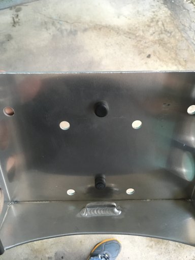

Welcome to the club. I got to a point and I just couldn’t stand using them or seeing them thrown in the woods anymore. I have a custom tank holder held in place by a Fourtreks mount. Old pictures but you can see it well enough.

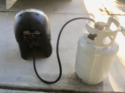

I have the 10foot hose similar to that. I thought about the 11lb too but the 5 just fits everything better and lifts down off the roof easier. Though with the 10ft hose I may not need to always take it down.

I have a T and assorted hoses so I can run multiple things at the same time.

Sure thing @QCrunner. It started out as this mount because the 11lb worthington bottles have the same diameter as the 5lb bottles (different from Manchester bottles)...
Propane (BKT-2286) Mounting Bracket, Fits 11 lb. Worthington (2.5 gallon) Propane (LP) tank or the Manchester 10 lb. with a 9" diameter Propane tank
The necessary modifications are pretty clear.
I added a ‘cleat’ to the bottom to help secure it in place.
Without going into every detail, here is how it attaches to my basket..
http://fourtreks.com/parallel_modular_mounting_bracket.html
I went with the Worthington 5lb bottle since it’s shorter than the Manchester. I’ll take the added clearance since it’s mounted on my roof.
Can you link to the 10 foot hose? I would like to use my new tank on my heater and stove.
