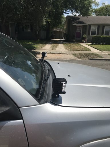

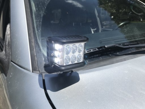

For the less is more approach, I went with adding a set of combo pattern ditch lights. Haven’t even turned them on at night yet, but this is me upgrading lighting while keeping it simple. IMG_1850.jpg
