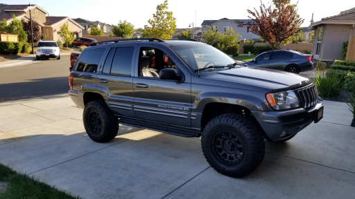

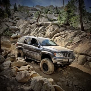

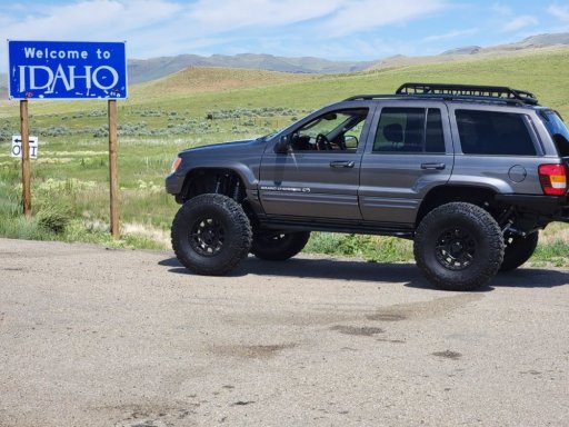

PS- this is my WJ:

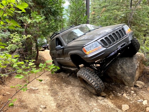

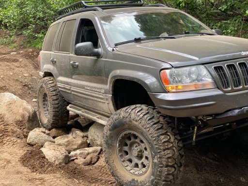

Thanks, I'll dig up a pic when it was at the 4" lift with stock driveshafts, axles etc. too. If you have anything other than the DC then you *should* upgrade to a DC at 3" or above.
This was on an Iron Rock Offroad 4" (or was it 4.5") Rock Link front long arm, rear was stock arms with the wishbone spacer (and obviously coils and shocks). I had some other goodies like Kevin's OR Over-the-Knuckle steering, front JKS quicker disconnects, Addco rear sway bar, some additional skids, Kevin's sliders, etc. Being a Quadra-Drive rig it worked really well (I actually think the Vari-Loks are pretty decent if you keep tire size/weight in check). The tires were ~31.6"s. It was a pretty perfect combo... so of course I cut it all up and went stupid. :D

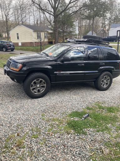

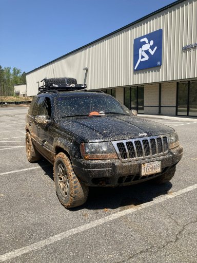

That thing looks absolutely awesome, here is a picture of my 99. A little hard as a high school student to heavily modify it but found some pretty solid Rubicon wheels with good tires on them. The only thing done suspension wise is a .75 inch leveling kit from rough country. I also have 1.5inch wheel spacers on. Do you think I would be able to run a 2 inch lift without doing a driveshaft swap? About to get some new tires and they have a pretty aggressive tread so I want to minimize my rubbing.
Thanks for the help man I appreciate it! I know my rig doesn't compare as well as others on this site but I think its pretty good for a high school student working a part time job!

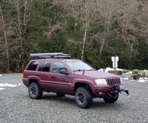

We have a 2000 Limited, installed a 4" Iron Rock long arm kit on it, had the razzepa drive line, and had to change to an aftermarket shaft mainly due to the fact that the bell shape of the razzepa was not wide enough due to the increased drop causing it to rub on itself. went with a Tom Wood double cardan. Keep in mind that you will need to change flanges at both transfer case and yoke at front diff as well as the shaft. Had to play around a bit to get the caster correct after the lift, you will have to fight the battle between optimum pinion angle to make the driveshaft happy, and the optimum caster angle to prevent death wobble and crappy steering. without cutting the C sections off the front axle and re-welding at the correct angle you can not get both in spec. We did find a happy balance and the rig drives great now. One thing to note wiht lifting the WJ is that due to the shape of the wheel wells you have to go up a whole lot to fit much bigger tires without hacking up your wheel wells. We like the look of the factory wheel well so could not go as big as we wanted. Totaly love the WJ and its a very capable vehicle with lots of comfort and since they made so many of them, used and new parts are plentiful.

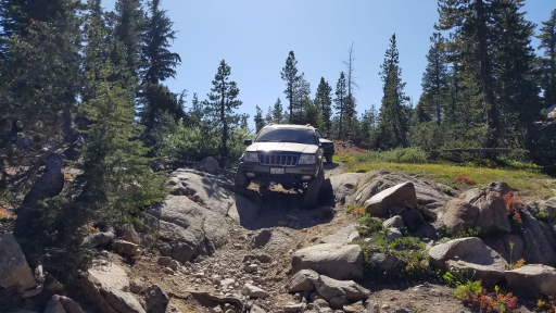

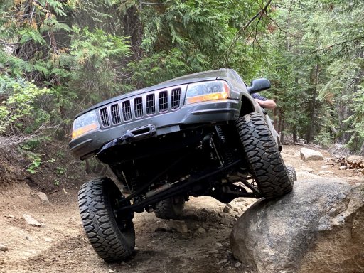

That's an awesome rig for high school. I drove a '84 Chevy Cavalier in HS. ;) You're doing great. You probably can run a 2" without a DS swap, but really with WJs you're not going to be able to run much (if any) more tire at 2" than .75" level. But if you're just trying to minimize rubbing with your current tires it could help. That said, trimming is where it's at. At 4" of lift and 265/75-16"s I had to do some pretty extensive trimming on the bumper cover and inner wheel well liner, as well as relocated my washer bottle (I used a ZJ bottle) and delete my fogs. In the pic above flexing on the rocks I actually was getting into my washer pump motors and the fog lights all trip. Somewhere I have pics of exactly how I trimmed it.

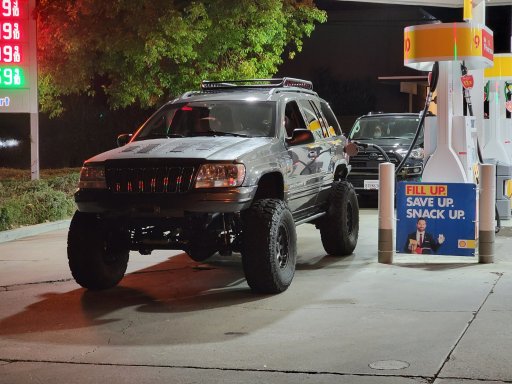

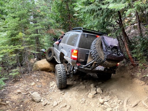

But the front bumper is mostly just gone now, and rear is aftermarket/custom:

Perfect height/stance for a WJ!
