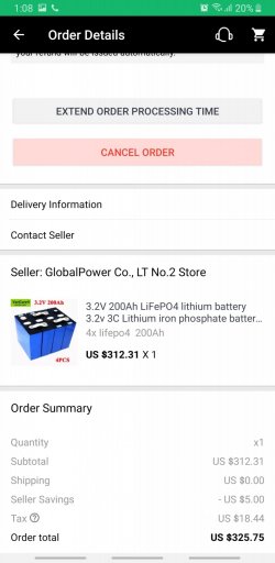

I went to Allie Express, did a review and found Global Power as a seller, who offers a set of LiFePO4 cells at 12v, 200ah and paid $325 (tax and shipping included). Add another $20-$40 for a battery management system and a battery box with 12v ports to put the cells in and you now have a usable set up at 20-25% of what a name brand product will cost you. Same quality, seasoned to taste... just saying.

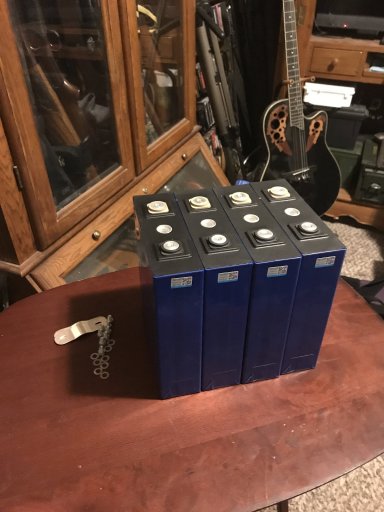

Batteries came in today, took two months and a week to get here, but they arrived. Letting them warm up. They were well packaged and appear to be in good order. Will know tomorrow when I assemble and charge them... fingers crossed!
