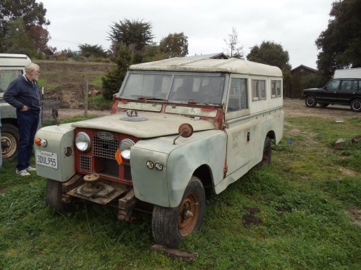

So turn back the Wayback Machine to simpler times Sherman, Jan 1974. I bought my first car at age 22, grew up in a house with no car, now my life was finally starting.
I drove my 1973 Land Rover 30 miles home from the dealer and got up the next morning only to find a huge oil puddle under it. I called the dealer, they said drive it back and we will fix it. I knew enough to know that was a bad idea. I looked underneath and saw the cannister oil filter was loose. I walked the half mile to the local Grand Auto and bought some oil and a socket set with a lifetime guarantee. Still have the socket set been thru a couple of rachets and socket, but that's besides the point. I went home tightened the filter housing and added oil.
Next day I called the dealership ordered a factory repair manual, $50, and never looked back.

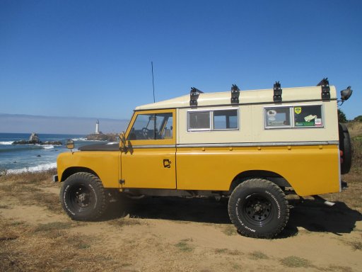

I've learned a heap by doing things myself, only the fan going through a radiator has caused me a ride on a yellow taxi to the nearest repair shop where I pulled the rad one evening, he fixed it the next day and I put it back in same day and drove the 150 miles home.
In my blog I go through my frame off resto-mod of my 1960 Land Rover. Welcome to Genocache!
I took a stock Land Rover galvanized all the steel bits I could and added 4 wheel disc brakes, power steering, oil cooler, 200TDI engine, LED head, running and lightbar, cots, rear door table, rear air locker, HD rear axles, Roamerdrive overdrive, dual fuel tanks etc........
Moral of the story, older vehicles are easier to work on, humans can learn to do a lot, if you know the why and how you enhance your chances of survival when you are "out there".
Before and after
