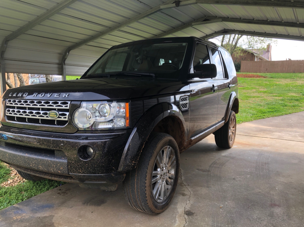

Wanting to overland build and plan out my future upgrades and additions and document them through here. I’ll be working on a 2010 Land Rover LR4 HSE “new to me” to take my family and I on future adventures!
I got the truck about 3 weeks ago and love it, love the capabilities of it, comfort, and add ons that come with it to make it a comfortable long trip vehicle as it is. However, some conservative and future extensive upgrades is what’s in store to make it that much better.
Hope to see you all on the trails soon and hope to learn from all of you guys and gals. Can’t wait to begin!

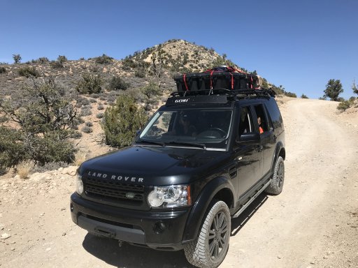

Day I took “ownership”:
3 days later added additional 2.5” lift:

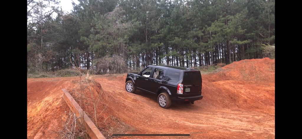

03/27....tested the lift:
More to come...

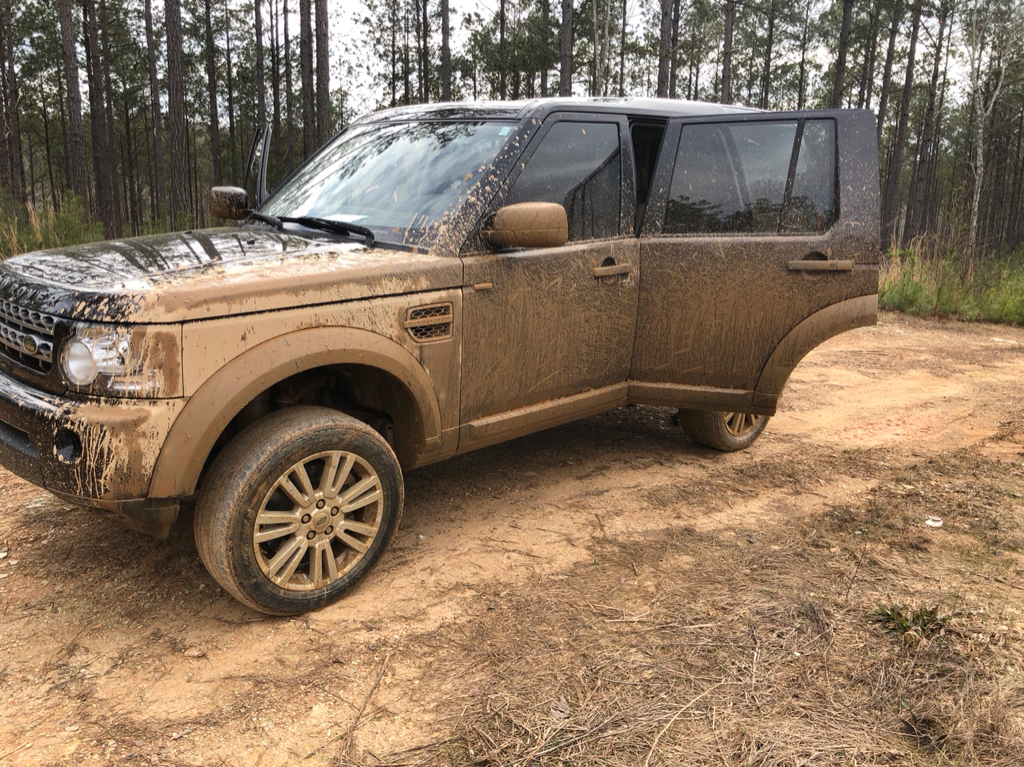

Thanks for the info! And yes I agree with you on that and am considering the IIDTool BT in the future to help with that as well, that way like you said a “just in case” opportunity.
In the muddy pic it was able to go “extended mode” without issue and was super excited about it. It’s good to have a suspension system smarter than the rest of the vehicle....sometimes myself of course. I’m going to probably run 275/65/18 in the short run and 265/65/18 longer down when I remove the rod mod, not looking to take many technicals at all but more so for reassurance of width and sidewall.

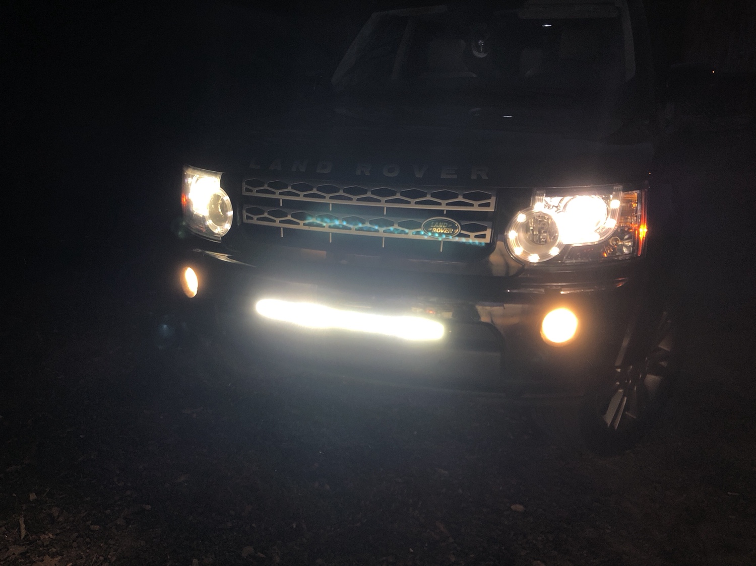

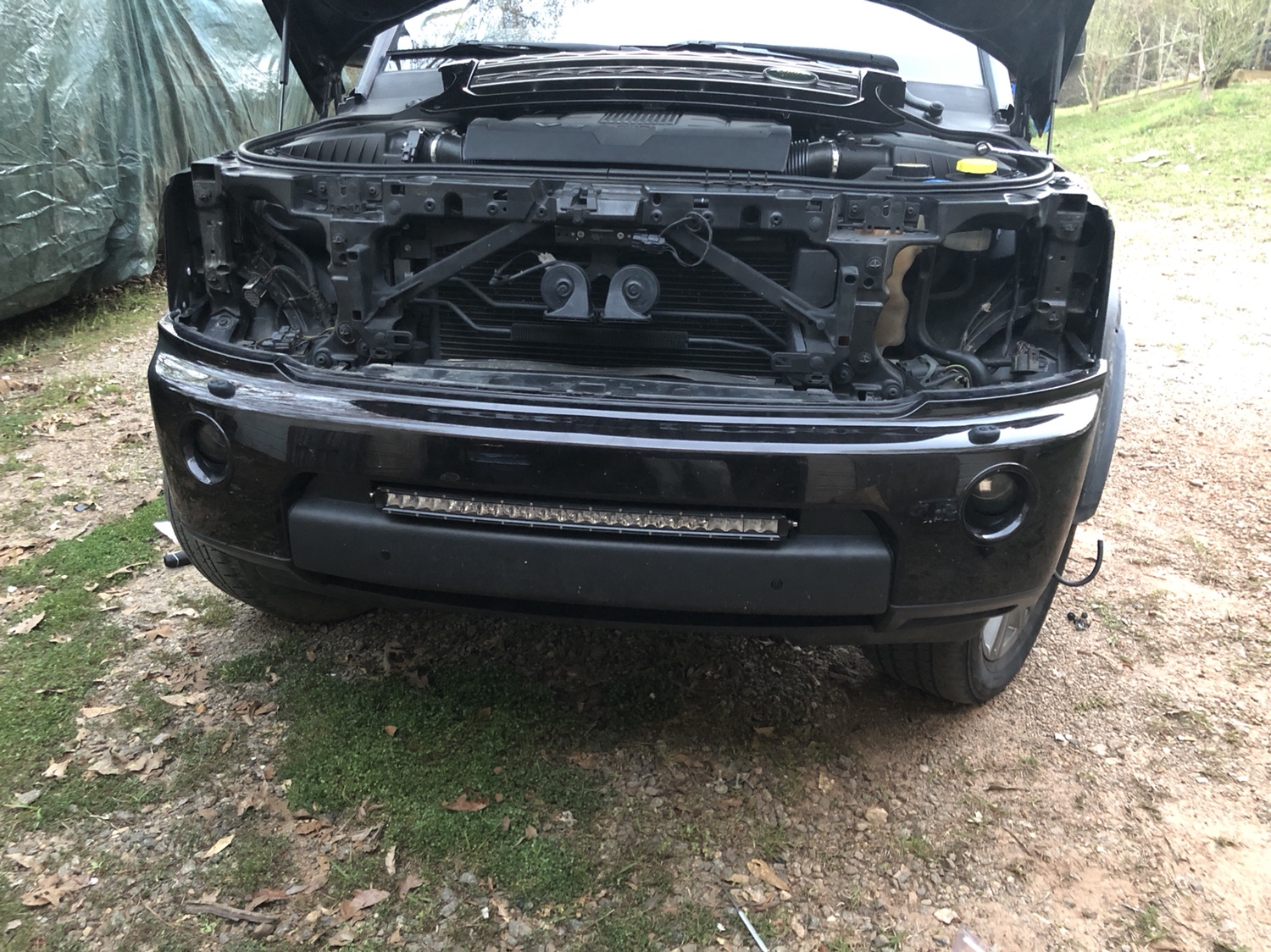

Update to the building! Just finished installing the bottom LED bar to the rig. Single stack LED bar I think 24”? Went on smooth just sucks to take everything off (bumper, lights, side well covers) just to get drill holes but wanted a 100% good contact for mounting.
Tied into existing fog lamps to assist with ease of install and use. Will be upgrading down the line with a switchboard for lighting with the additional lights I have planned for it.
Also, wanting to change the stock fogs to something to match the light output of the bar. Any suggestions on the change out? LED? HID? a whiter halogen?

Light bar looks awesome, I honestly didn't even think about placing bar on bumper...genius! If you don't mind I might steal your idea. Also, let me know how the Atturo's are, I like their beefed up sidewall, but didn't know much about them. Thanks for posting, keep 'em coming.

Shoot I got the idea from the FB group I joined and it fit nicely. Would have liked it to be a bit more recessed but for adjustments I wanted to make sure the allens on the side were available to me. Will do. I’ll have them installed Friday after they arrive on Thursday. I’m going to try and hit some trails over the weekend and pack some camping gear and take my girls out.

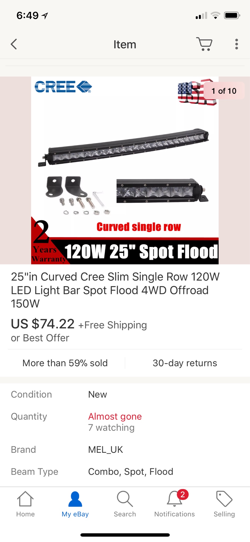

Side note. I’ll post the eBay listing on the light I got. Came with everything but instructions. And this placement gives a good center spread, I’ll leave the wide spread to the bar I want when I get my roof rack.....eventually lol

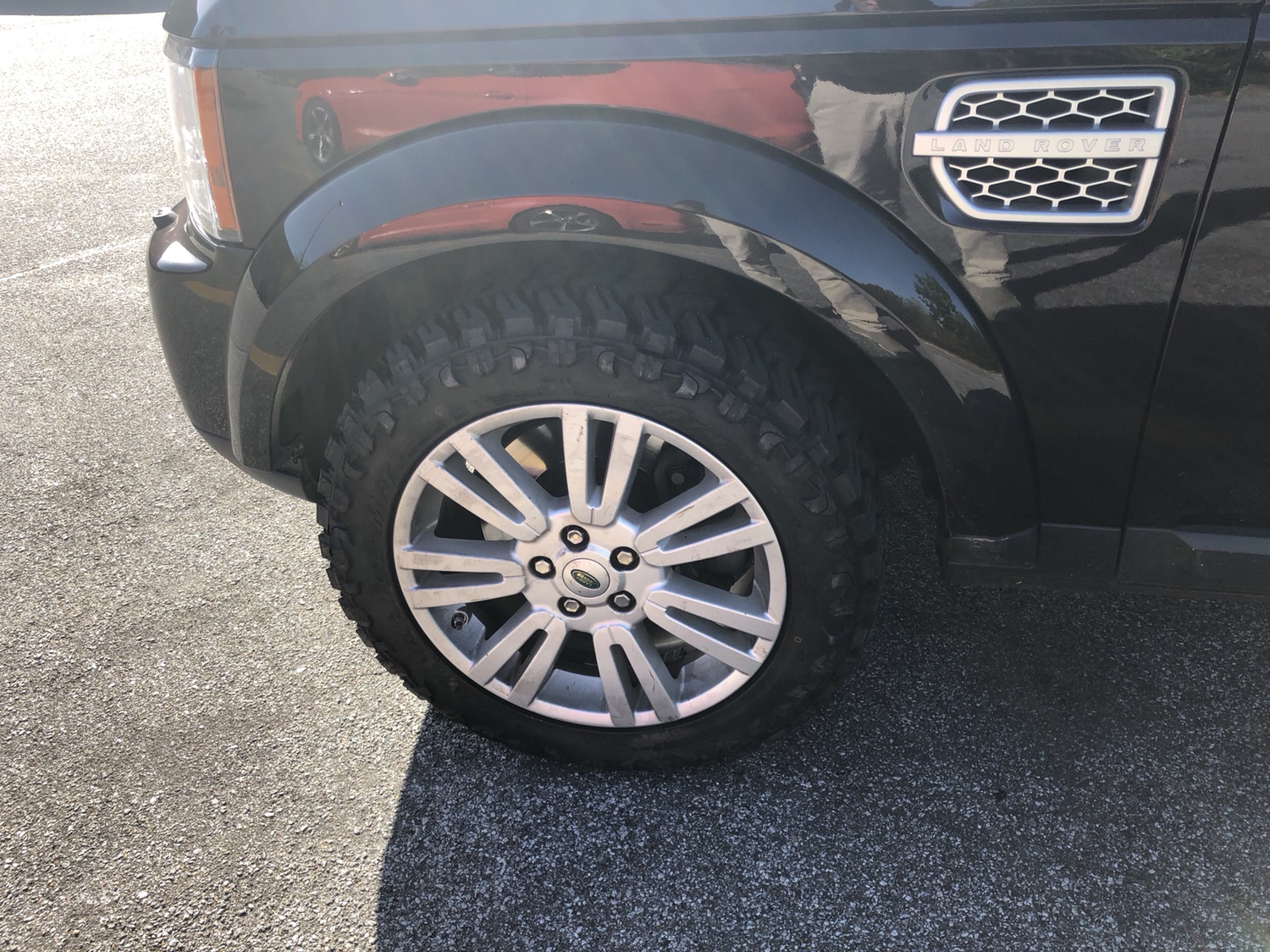

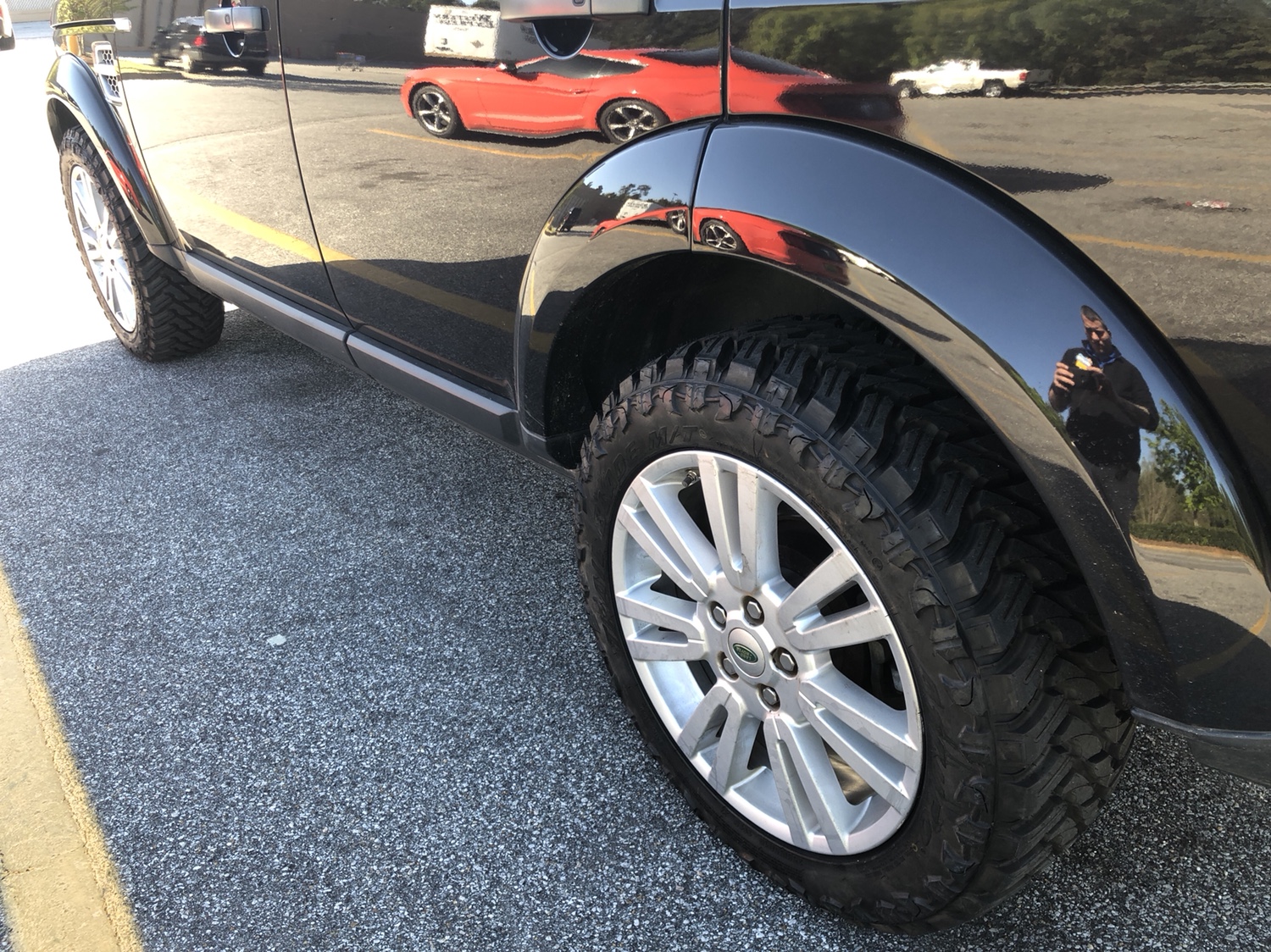

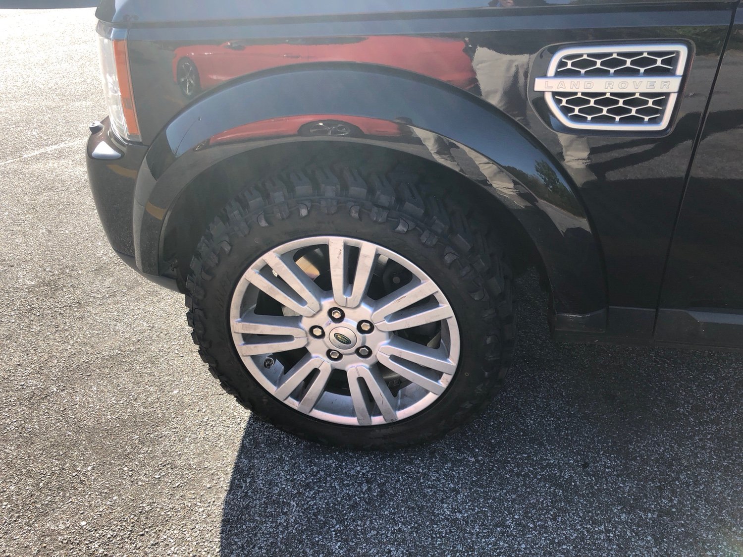

Update 4/5/18
Got some new shoes! Atturo 255/55/19 Trail Blade MT installed I will update everyone on the ride quality on and off road should be able to hit the trails tomorrow at some point with my kids (mild/easy trails).
BTW they look amazing. I know for sure down the rod on upgrading to 18” and beef up the side wall but for the stock format driver it looks great!

Those look mean, I like 'em! The sidewall looks extremely textured/tough and perfect for airing down. If I need to get new tires before I go to 18" I'm definitely doing these. As always, I look forward to hearing how they work when aired down to 15psi...and to a much lesser extent how they do on the highway.

Tires: they are whinny....smaller sidewall = higher pitch whine down the highway. Doesn’t bother me I just close windows and turn up the music.
Won’t be able to make it to any trails over the weekend due to work, but so far due to installer error I can’t give proper feedback on handling. (They didn’t remove the old weights!!!! So I’m getting vibration at the steering. Don’t worry I’ve checked all other variables as well, tie, cv, play, wobble.
On braking I can feel the additional weight and only amplifies the need to get rotors cut. I believe they are around 5-8lbs heavier than stock (passenger/suv) tires.

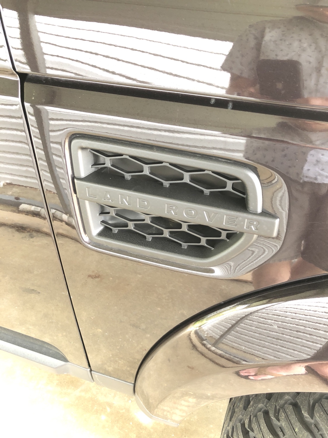

Plastidiped the intake covers, not the best job but doing what I wanted it to do:
