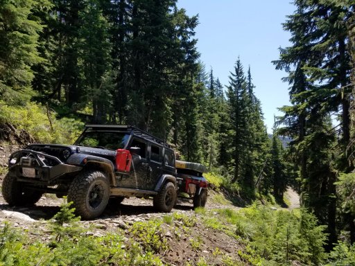

I have been contemplating which gear set to put in Number 7. I have 4.10s now, with an automatic and 35s. I do not plan on putting on bigger tires. She does pretty well now, but I don’t care for how she pulls the trailer over mountain passes. She always searches for gear. It drives me nuts. Lol
Some background; I drive a new 605hp Kenworth with 18spd all day during the week. I deliver excavators and dozers and what ever else. I’m typically 120000+ pounds. I go up and down those same mountain passes loaded and empty. I’m just having a hard time deciding.

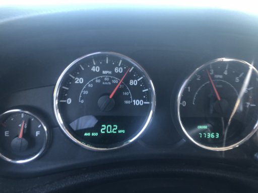

With stock tires and gears, rpm at 70mph is 2500. With 4.88 that rpm goes to 2723. 5.13s brings it up to 2862rpm. Not a huge difference, but enough. I would like to hear from others who have done either swap. Are you happy? Would you like to have gone deeper?

Funny enough, many folks are scared of the RPMs, but the 5.29s will actually give me roughly at the same cruising ratio as a stock 4Runner with a manual transmission and stock tires.

I think with your background you would be happier with the 4:88 you would get a lot of engine hum with the 5:13. I am currently running 4:56 with a 6 spd and stock tires (35's have been pulled off due to I am picked about tires and handling) and at 75mph it is about 2800 rpm. So my Point being it would be pretty close to the same in my opinion.
