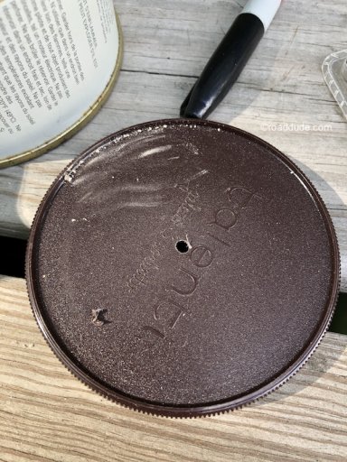

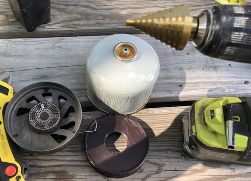

- a plastic lid from a jar of peanut butter or similar. I used one the kids had from some sort of Gelato treat.
- drill bit and tapered bit, or utility knife
Drill a pilot hold dead center in your lid, then use a tapered bit to drill it out to fit the ring on your fuel canister, as shown below. The lid I used already had a manufacturing divot dead center, so it made it easy.

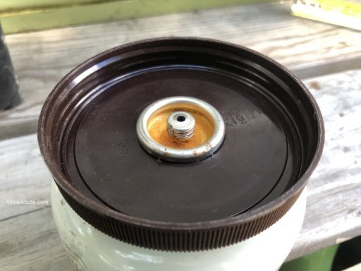

Try the fit on your fuel canister. A good snug fit lets you keep the lid on the fuel canister when storing.

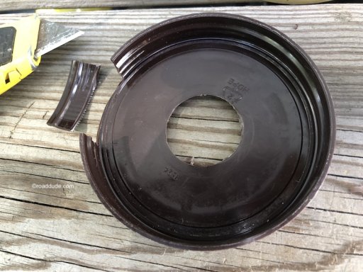

Once you have the fit the way you like, measure the width of fuel adjustment bail on your JetBoil.
Cut a section out of the edge of the lid, as shown above. I made mine 1.25" wide. This allows the adjustment bail to operate freely.
You can cut the entire screw edge off, if you like, and just use the remaining flat disk. Or start with a flat piece of plastic and cut the hole. Though I like the raised lid edge because it will make it far less likely to be misplaced or lost.

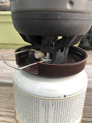

Snap it back on your fuel canister and screw on your JetBoil burner and cup.
It will now be rock-steady.
