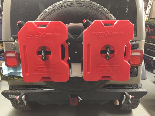

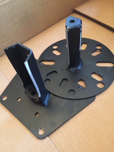

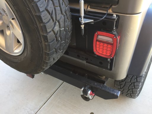

To carry these supported by a Morryde tailgate reinforcement (upper mount connects to the rollbar mount and the bottom is bolted to a backing plate):

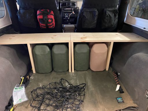

I built simple wood racks to make storage and accessing heavier items such as water/tools/recovery gear easier. I glued outdoor carpet (similar to the interior color) to all surfaces and bolted on D-rings to secure items (not pictured):

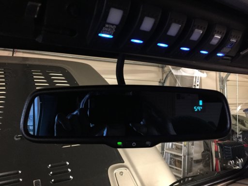

I discovered my 2004 Rubicon was wired for the temp/compass rear view mirror. All o had to do was buy the temp sensor (mounts between the radiator & grill, driver’s side) and a compatible mirror w/wiring harness (Amazon). The temp sensor plugs into its respective harness in the front. I had to modify the inside connections since I was not able to locate an OEM wire harness to connect the mirror to the connector under the panel you remove to access the center dash bolts.
