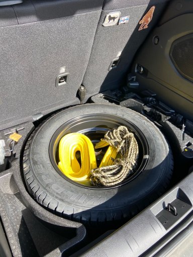

My little Jeep is limited for space… so I found a solution in the Renegade forums.

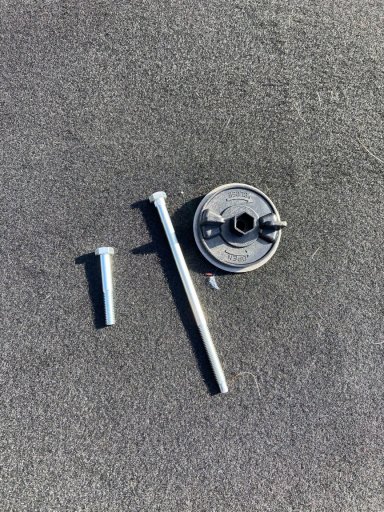

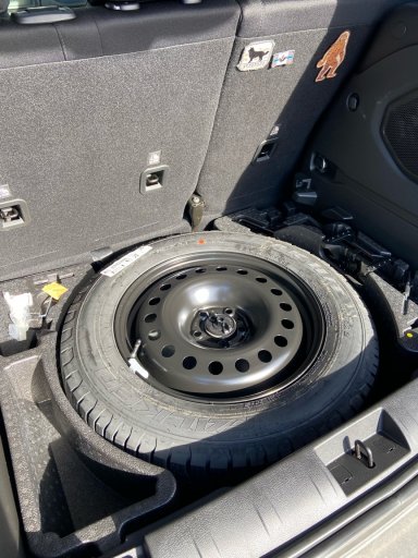

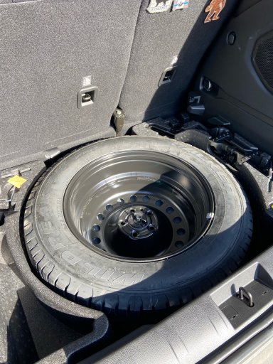

My Trailhawk has a full size spare under the cargo area. I picked up a shorter bolt ($2) and flipped the spare tire the opposite way. See the photos below.
For $2 and 10 minutes work, got me some free space for my straps and rope. I hope this helps. The bolt size is M8X1.25 60.
