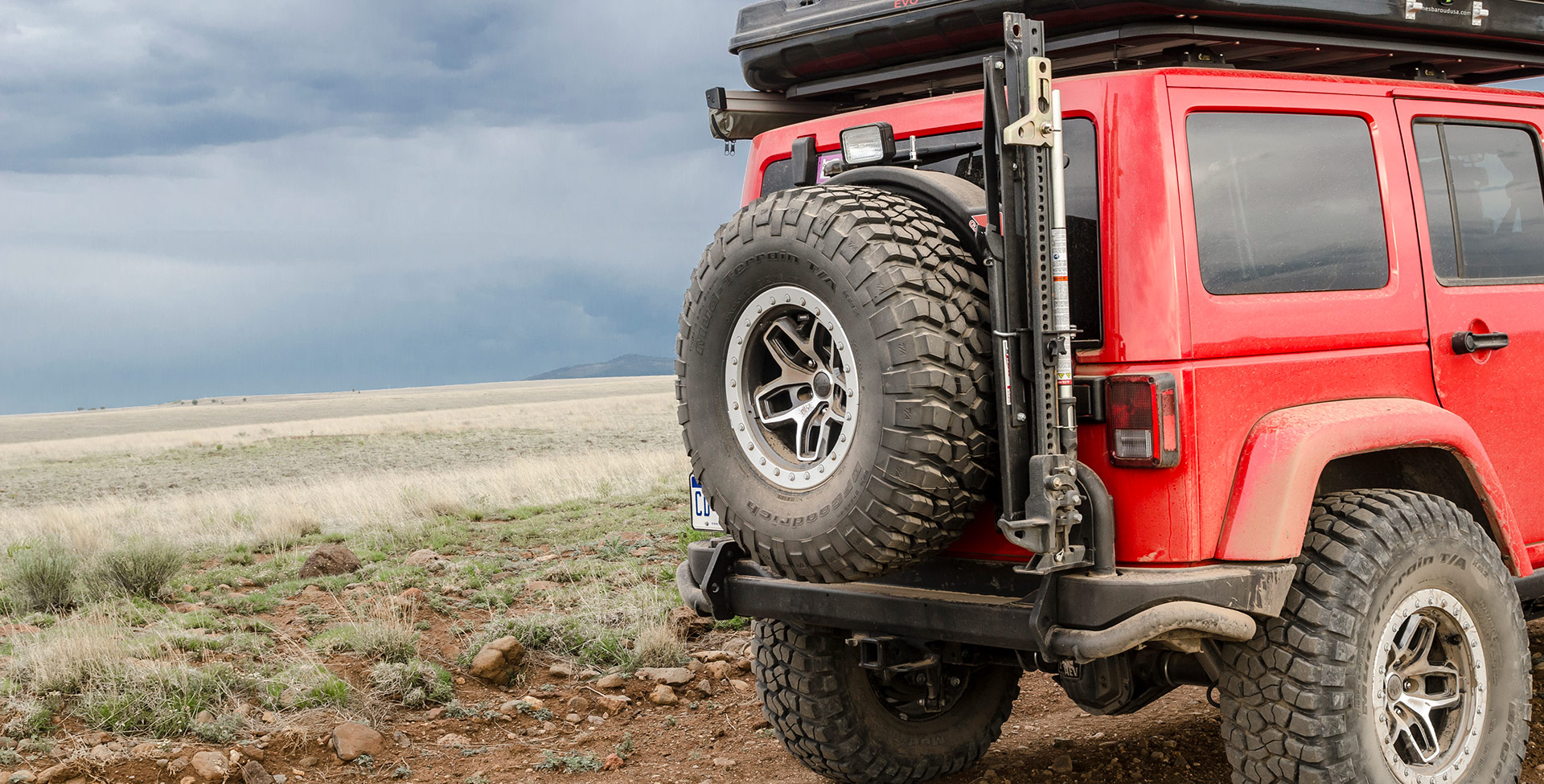

Some other considerations.
I have the AEV rear bumper. It is available with a plumbing kit that attaches both pods together then has a handpump that mounts in the drives side pod. Love mine and easy to fill. Remove the pump when driving and replace with cap. Reinstall for use. You do not need to use/buy the tire carrier, but that pod is the one that is plumbed by AEV and will have a sealed hole where the mount would normally go. I have an OEM AEV stamped MOPAR bumper that came with my Winter Edition. It did not have the plumbable pods. I bought the 2nd link and it took about an hour to install.
The "OEM" plastic rear bumper is a solid unit, minus a couple of small drain holes. It can be tapped, filled and plumbed with a pump or by gravity. Holds about 7 gallons.
