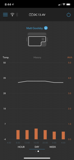

-Dometic CFX3 55IM (ice maker off)
-Jackery 300 (rated 14.4v and 20.4Ah) (100% charged)
-Inside controlled temp 75 air conditioning no sun exposure.
-Prechilled to 37 degrees and left there for duration of test
-Plugged into 12V DC on Jackery 300
-12 pack and couple water bottles
Started on Thursday 6Jul 0800 with 100% on Jackery 300, contents and fridge at 37 degrees F. Throughout the 24 hours there were multiple openings and putting in a few warm beers to cool off. 24 hours later 7Jul 0800 there was 20% power left on the Jackery 300. Observed on avg 50 + or - 5 watts while compressor running.
Hope this help some people with data points and deciding what AH battery system they want/need. That’s all, going to open and grab a cold one now.
