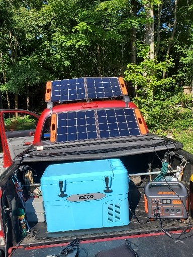

Have this iceco fridge running for days now. Set at 37F. The 1000 uses 14 percent at night . Next day it's back up to 100 by noon.
Ok I give up, I deploy 120 watts of solar panels. Our fridge set at 38f uses less than 3% of available voltage using a pair of AGMs @125 ah, with ambient temps in the 80s / 60s. In perfect sunlight conditions the AGMs are back up to 12.9 volts in a couple of hours. So, what are the numbers for your set up? Just curios, my son in law is seeking my advice on portable power options. As with everything, the manufactures stellar numbers are what the product might be capable of delivering, in perfect conditions. Thanks
Thanks
In not a tech guy. Hope this helps you. These are for the unit and one solar panel.
