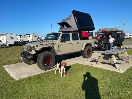

I have a 2020 Jeep Gladiator with a 2 1/2” lift running 37s. Since adding a full height Rebel Off-road XPLOR rack and a roof top tent I’ve noticed a considerable amount of sway. Especially when cornering on the road at speed (created some major pucker factor at times).
I’ve solved the road sway by switching to a Hellwig sway bar. It made a huge difference.
The next thing to tackle is the jostling back and forth recovery when driving off road. For this I’ll upgrade my shocks to something that is adjustable so I can stiffen them when on rough trails.
I’m looking at the Falcon SP2 3.3 piggy back adjustable shocks, but I’m open to suggestions and curious what a others are running.
Thanks - Dan
