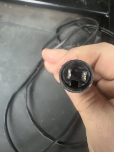

I have the ARB screw-in style socket that came in their wiring kit (ARB-10900027). Now that I have an ARB Zero fridge, I want to replace my current Blue Sea 12v outlet with the ARB one so I can secure it. Problem is, it is not working the way it is supposed to. I unscrewed the cigarette lighter section on my cord that came with my ARB fridge. I can plug the 2 prong plug into the ARB socket. However it will not screw into the ARB socket because there are not enough threads in the socket and the plug bottoms out before it can engage the threads. It cannot be pushed in any farther. I've used a ton of force. The screw on portion just spins and never tightens. I don't know if I have a fluke bad outlet or a bad plug, but both are ARB products and are supposed to screw into each other to secure. They do not. Wondering if anyone has heard of this issue before I start re-ordering the parts I have. I can no longer exchange so I'd have to order new parts.

Strange, I've been using this combo of an Engel Posi-Fit style plug and the ARB outlet for years and it fits perfectly. And you can not really do anything wrong, right? Just unscrew the front part of the plug, then this fits because of this small plastic nose only in one position in the socket, plug in and screw. When I'm at the rig later, I look at that thingy again and maybe I have an idea about it then. I'll get back to you later.
So, I just looked at it in my rig. I just have to plug it in and screw it down, that's it. Take another close look at the plug, maybe something is stuck? Or please show a photo here, maybe someone has an idea then/ it will be clear what is not working.
I replaced a 12v outlet with the same ARB plug kit. It has been a few years, but I do remember that the plug did NOT initially want to screw on. If I remember correctly, I trimmed or smoothed something and it then went on easily.
The plug is keyed and will only fully seat one way. If you are not paying attention it is easy to miss. As a matter of fact, I just went out to my vehicle to inspect the plug for any possible threading issues and initially tried to plug it in upside down :laughing:
Your plug should look like this....The socket should have a male key that will fit in the channel at the 6 o'clock. once lined up you have to push the plug in until it stops then screw the outer sleeve to keep the plug in the socket. If they are not compatible you might want to make sure the socket isn't like a cigarette lighter socket possibly. Otherwise I would check for debris in the contact holes and the like.
Reactions: El-Dracho
I had a the same issue with mine, missed the key orientation first time, and also had to push the connector in a bit extra firm (once I had it right way round of course) to get it to seat fully. Best part is it has been a year and no more issues with plug backing out on washboard roads
Thanks for all the suggestions. I had tried everything, and the plug only goes in one way. It would slot in but would not thread, and no amount of force was getting it in any further. I went to the local shop who sold me my fridge and they had another outlet. They swapped it out for me and the new one didn't have the issues. Threaded on super easily. Same part, and they looked the same. One worked, the other didn't. I guess I just got a bad one. Working great now with the new outlet!
