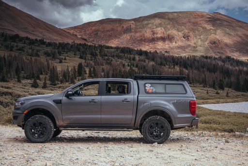

For reference, here’s what someone else did with the same rack on a Colorado…trying to avoid having the rack mounted so high above the top…

My setup is a hair different because my topper did not come with integrated rails. I elected to buy the rhino rack pioneer system with their universal backbone. Backbone is secured to the topper via drilling through it. I am happy with the height this is at, the backbone is 1-1.5 inches tall and the platform only sits about 3 inches above the roof line. I find wind noise is pretty minimal and I can still fit in my garage just fine.
